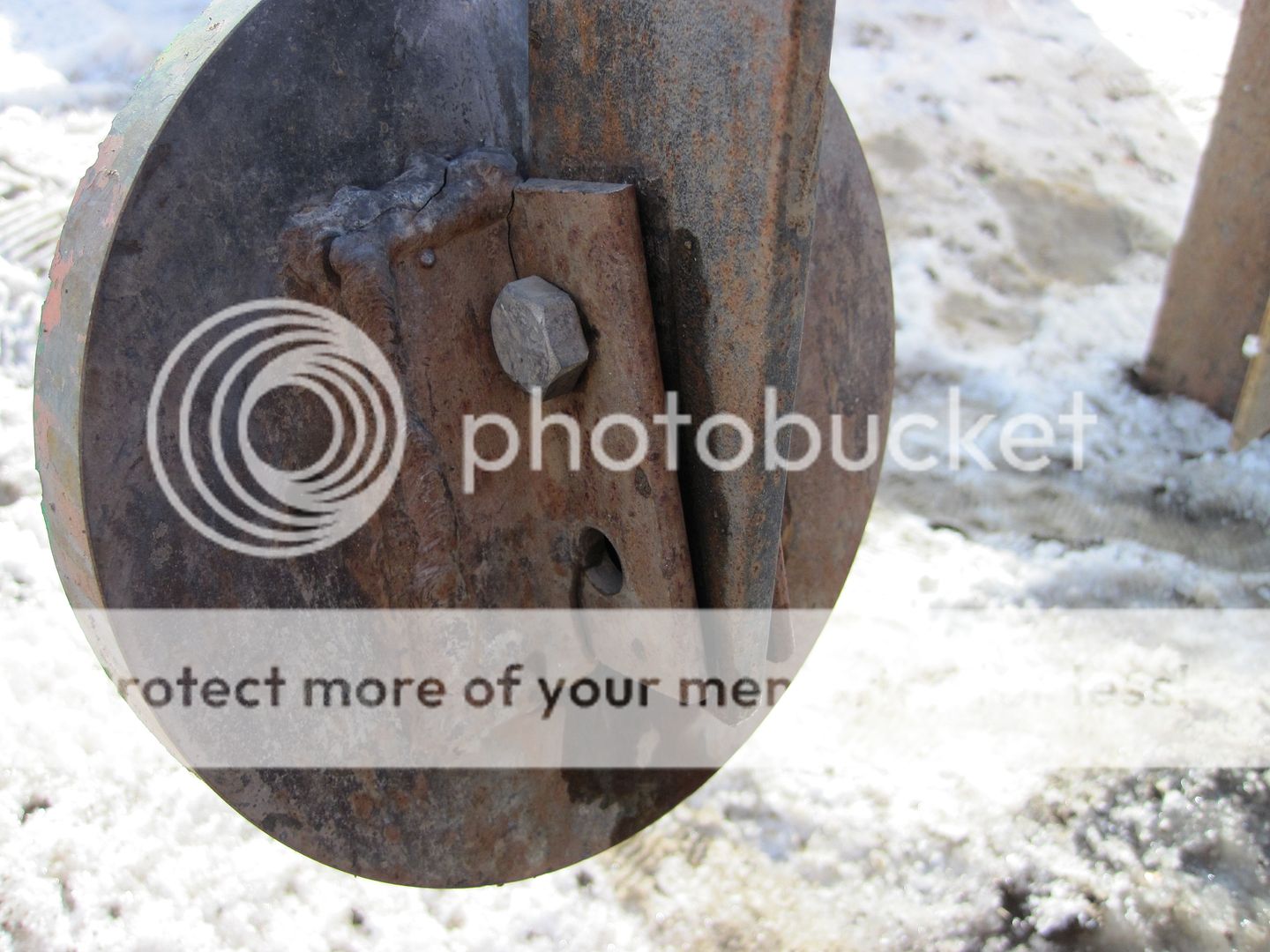

This is the system we use at SPFGA - it involves welding two brackets to the back side (watch the heat does not take out temper)---then install a "hanger"---hung from an upside down L made from grader blades. Bulletproof, but the welds eventually crack after thousands of hits.

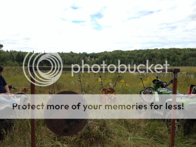

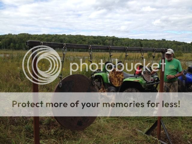

Here is how I made mine, they just swing free !! works great
Doesn't count... not AR500 =)
Looks good. My buddy welded up some stands that knock down. The issue being is they are bigger, heavy, and take some setting up. The benefit is they work very well as long as you don't shoot the stand. His are bolted on so the hangers can be replaced. Bolts tend to loosen though.
