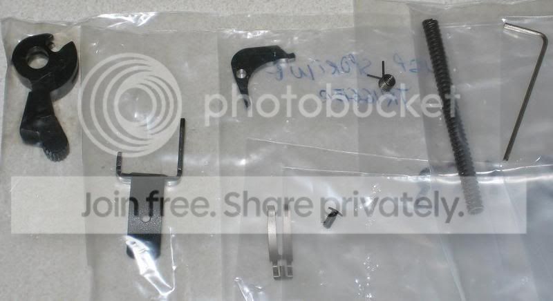

This is the match trigger kit I bought from a fellow CGN'er:

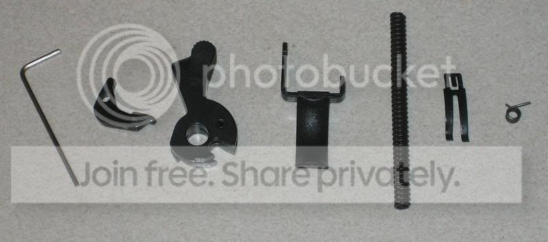

These are the parts that are now out of the gun. All of the parts in the first kit are now in the gun, with the exception of the little round spring. The round spring is the same in both pictures. Apparantly the trigger wouldn't reset with the other one in it. You can see that the "sear"-type part is quite a bit different from one pic to the other.
The kit seems to be installed properly, and everything seems to be working just fine... except, I take it to the range today, and about three times in the first 250 rounds, it does this thing where pulling the trigger - either in DA or SA - drops the trigger to the half-#### position (the place where the hammer goes when you decock... normally when you pull the trigger the hammer should go all the way forward and hit)). Then you mess around with it a bit, keep pulling the trigger, and it comes to its senses and goes back to working normally.
So what is your diagnosis based on this? Is the kit installed improperly, or is the kit just need to be "broken in", or is there one or more parts in these pictures that should not have been installed/removed? I'm pretty sure it has to be one these three options.

that could be the problem. From the top pic, I can not tell which hammer it is, but I am assuming it is the hammer with the U shaped notch in it. The "little" spring is the trigger return spring. It is softer/ lighter than the regular spring. IF it would not reset with that installed, there may be material around the trigger that could be causing it to not reset (ie: plastic shavings, dirt , etc..) Match triggers are recommended to be installed by certified armorers. They don't come out of the factory not working(!)
Make sure the overtravel screw is not out too far, although that is a seperate matter, which should not cause the symptons you are describing.
Lets hope the sear spring (the stainless part that the hammer rides against) is installed properly. If it is broken or bent, it could cause the problems you are experiencing. ALso, if the detent plate, or anything is installed out of order, it may cause the problems you have described.

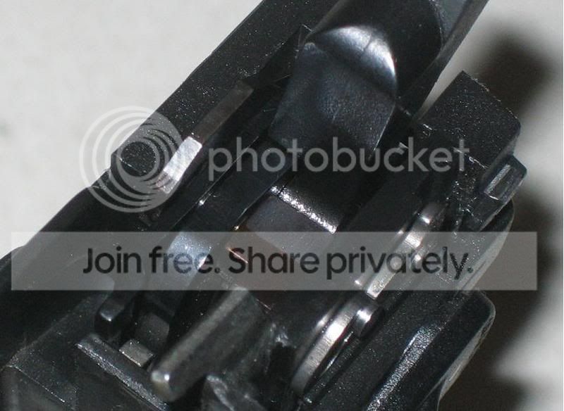

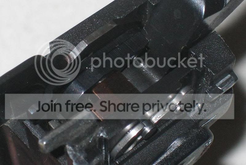

Here are some pictures of the culprit. I spoke to one gunsmith today who said "Sear spring engagement is the issue", and that he has dealt with this issue before. "Sometimes they fit a little too tight inside the frame and hang up alowing it to drop to half ####, but like you said, inconsistently."

This is how the gun is set up right now. This shows the longer hammer catch going into the gap in the "S"-marked hammer.
This shows the hammer in the de-####/half-#### position - with the hammer resting on the catch.
Something may be wrong in this photos. I really don't know. The issue is incredibly tricky. I'm not going to touch it myself. I had a gunsmith do it the first time, and even that wasn't enough to ensure it was in properly.
