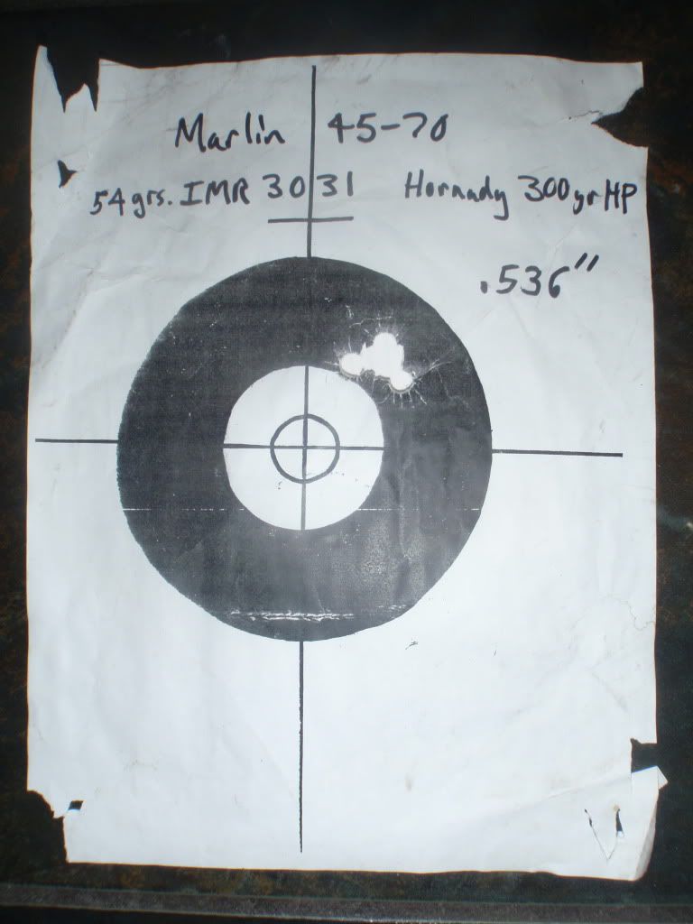

I have been using 3031 and 405gr cast in a 1895 and a bolt rifle. Seem to get good accuracy with loads that are mild or tooth rattling. Used other powders but decided to stay with 3031.

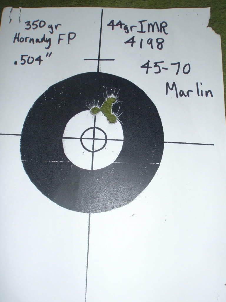

I use IMR4198 but bought some Reloder 7 to try. Has anyone used Reloder 10. From the loads I've seen on the Ranchdog mould website it's supposed to be the fastest powder.

I use H4198 and my marlin seems to like it.
34gr under 350gr hard cast is about 1200 fps, IIRC
37gr under 300gr Hornady JHP and 38gr under 405gr Remington SP also work well in my rifle
