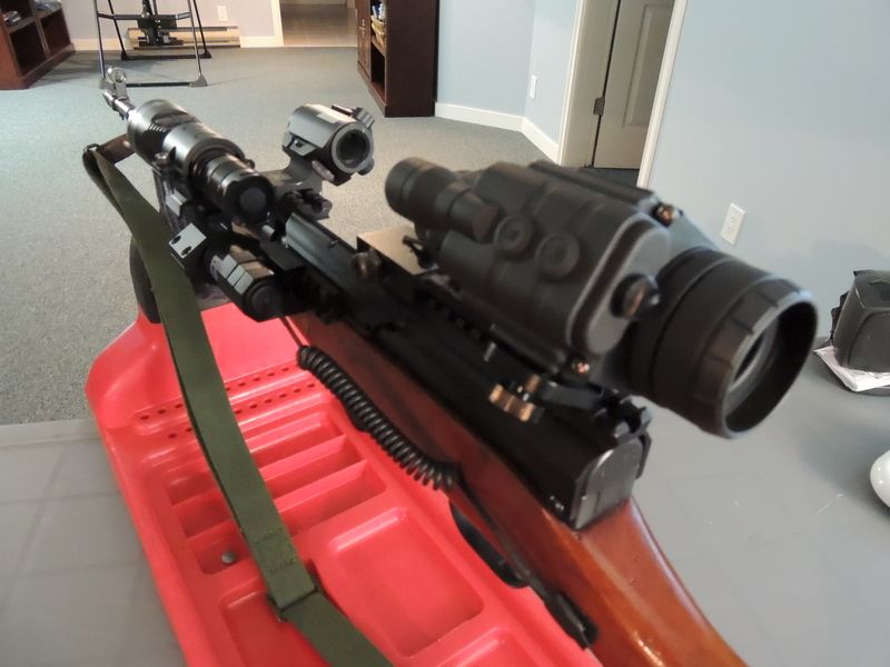

Magwedge Gen 3.
Wow, I never quite imagined a guy could hang that much stuff off our rail system ..... showing off its full potential there.
I imagine all the extras add some weight, but since the rail keeps them close to your body rather than forward of the receiver, I suspect it will be easier to handle ... the rail itself is very light, about 120 grams, or 4oz for the metricly challenged.
