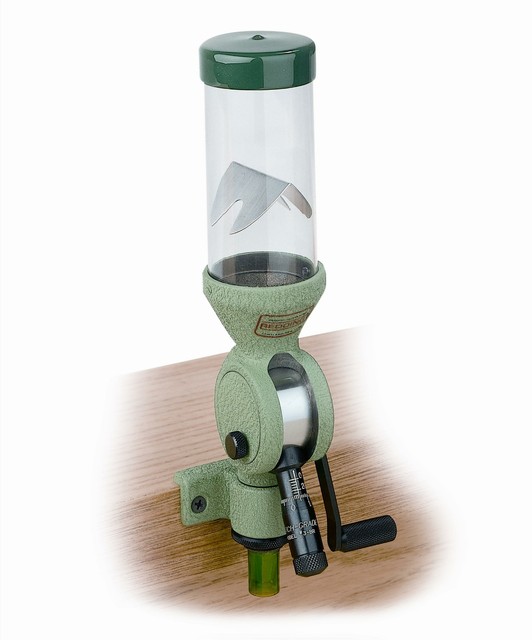

Redding powder dispenser will make you wonder if running every load through the Chargemaster is worthwhile or a waste of time

Does the Redding work well with stick powders or is it best with ball and shorter extruded powders? My main reason for adding the CM Lite was to dispense my extruded charges since I mainly use them in my rifle loads. Trickling plinking loads is tiresome and I'm way too OCD to not trickle down to the last granule to zero. I have the Lee Pro Auto Disk and a lapped PPM, both do great with ball but aren't consistent with extruded.
I am hesitant to recommend any powder thrower to someone that is OCD enough to trickle plinking loads. Laugh2
But the Redding does pretty good with powders like H4350 and H4831SSC. Never tried it with the log like IMR4350. I have no problem using the Redding to load hunting ammunition using RL powders or H4350. It's consistent enough for that.
