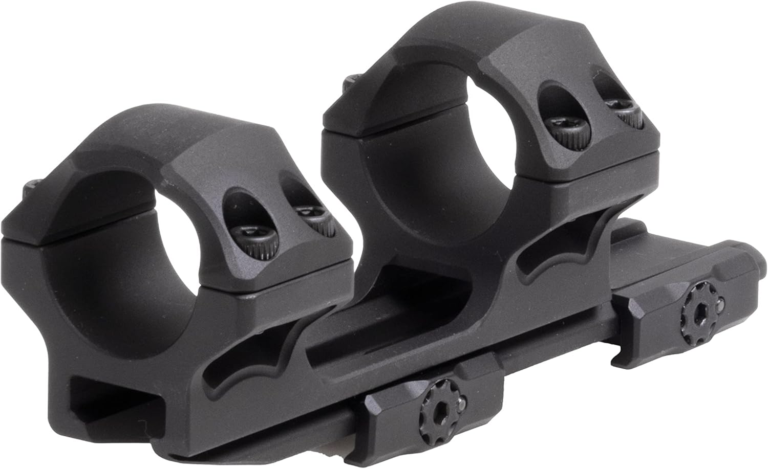

Take at look at UTG's offerings on Amazon and see if you can find one to suit your needs.... they are making pretty nice rings and mounts these days...
https://www.amazon.ca/UTG-ACCU-SYNC-Medium-Offset-AIR11834Q/dp/B09FC1QXVQ/ref=sr_1_1?crid=27OQEYO6C8B6D&dib=eyJ2IjoiMSJ9.fW39pB7kW-pqQl3UsiHf7cCqKkL88hkpeA8IDypAsw52OPpUdgrMkpHzUXdCCN8o6nnN4tiRqAkeaYvzuwBcOU1XurGnBCjMy58OABOTwC13051_tU3Scdc3_lanmj-0AFRDUyuB1YObNprIWi1Nwl9701Cm7P5AuunVTtHwU6wTWWvH8og64cQFYeGCJRDos5UCSg3qSohCgBkP8_c4QI16y4d5_VZYwb9QIjcDV87sIZqBC7zvymfCtPnxQay1CZZz0oH4zFtK_A71EqhILPMjzASKIOsZ3U6pcwxth84.5DYVIcHKhK7KVTonqgd01DFQTjOsl5fE-5Q4cXkTiDY&dib_tag=se&keywords=utg+pro+1"+quick+detach+scope+mount&qid=1746500208&sprefix=utg+pro+1+quick+detach+scope+mount,aps,1108&sr=8-1

I've got a burris PEPR mount, and if I was buying another similar mount today I'd buy the UTG that I linked to for $110.00 and call it a day.... :)
