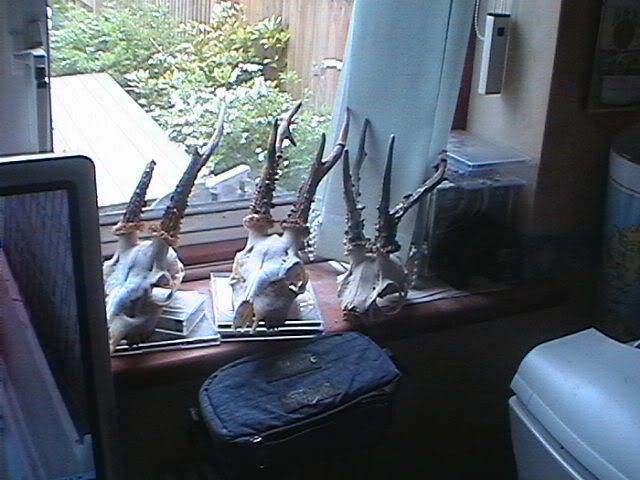

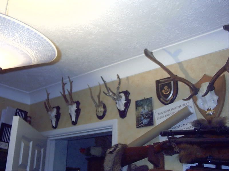

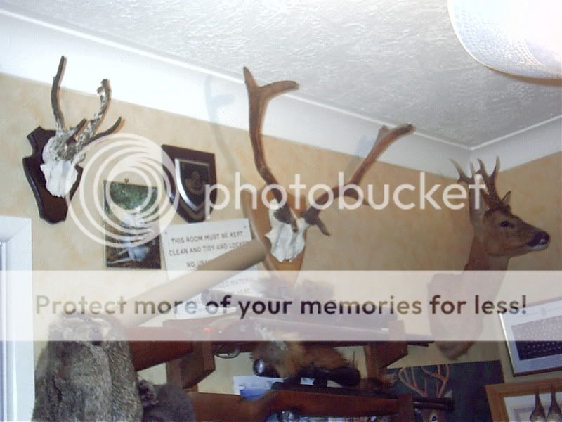

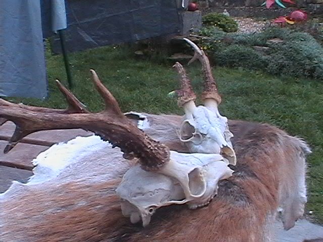

If you use a bleach solution for finishing and it splashes on the antlers, dont worry as brown boot polish can work in very small quantities and I buy all sorts from STS in North Wales. I boil my skulls for an hour or so, and then jet wash the crud of them. I'm building up a small trophy room at home. European deer of course so I cut the skull unless its of to the taxidermist and mount on a shield.
These are waiting shields.
Freshly done on top of their pelts.
Part of the old wall!

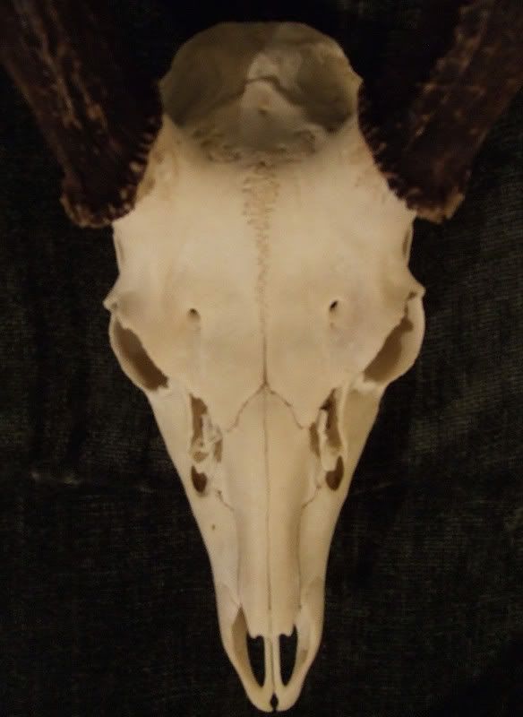

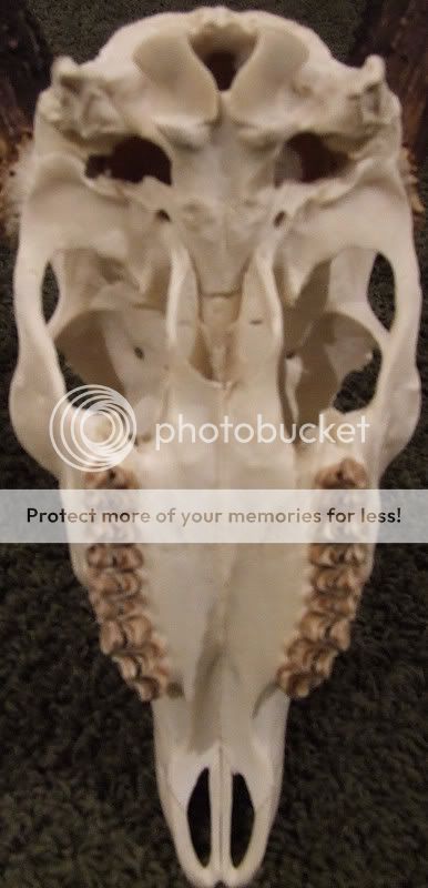

I used the Cascade dishwasher powder instead of baking soda as it does not froth. Three water changes (might be a bit anal) and a 15 minute boil to each water change gave me this result. No bleaching was done at all, this is how it came from the water the last time! By far the easiest and best result I've had in 10 years of monkeying with cleaning skulls.:cool:
It was soaked in very cold water and scrapped very clean before the hot water sessions began.
