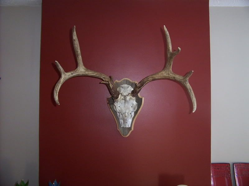

Is there a trick to the bleaching that I'm missing? I had mine all nice and cleaned up after two slow boils, and then I went and brushed bleach all over the bone...and nothing. What the heck??? Any tips?

Ah, it's the soaking in bleach that I'm missing. I'll have to do that. Thanks for the tips!
In the meantime, my wife figured it looked fine even half-bleached, so she twisted my arm and made me stick the mount on the living room wall. This is what my hack-job looks like (the cats ate the palate/nose bones) --
