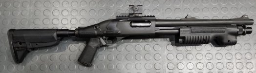

My circa 2015 Rem 870 Police Magnum has never skipped a beat. I have fired several thousand rounds of 2 3/4" and 3" shotshells at clays and Geese/Ducks over the past 7 years using a 28" vent-rib Barrel from an 870 Express, along with the occasional defensive work using 2 3/4" slugs out of the stock Barrel. The stock, 14" rifle-sighted Barrel is surprisingly accurate out to 100m with slugs. The pump-action is very slick, and gets better by the day.
I cannot say enough good things about the Remington 879 Police Magnum shotgun. No wonder they won the hard-earned trust of North American law enforcement everywhere!
Add-ons:
- BCM Gunfighter Buttstock
- Kynshot Hydraulic Buffer Tube
- Mesa Tactical Pistol-Grip Adapter
- Magpul MIAD Pistol Grip
- Mesa Tactical Picatinny 6-shot Sidesaddle
- Aimpoint Acro P1
- Streamlight "TL Racker" Flashlight Forend
- Mesa Tactical +1 Magazine Extension with Sling Loop
