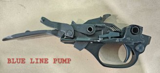

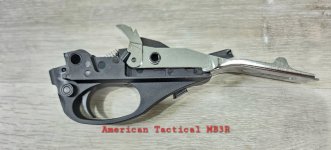

You made me curious about that so I had to check. The differences of the dimensions inside the trigger guard seem to be very minimal though. The ATI has pretty much the same dimensions and shape inside the trigger guard as the factory 870, having a bit more in front of the trigger. Where the Blue line has a bit less in front of the trigger but more space up and down. Here's some pictures with the dimensions- (measurements for front to back are from the deepest part of the curve on the trigger to the farthest edge inside the trigger guard) 1000020212.jpg1000020210.jpg1000020208.jpg1000020209.jpg
Thank you for these. Appreciate your attention to detail.
I imagine both use MIM parts? Any idea which has more?

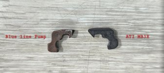

I was under the impression that the BLUE LINE extractor was machined but it does look like it's a MIM part same as the ATI MB3R extractor.1000020236.jpg
So it's the extractors and atleast one component maybe more in the trigger group assembly.1000010008.jpg1000008091.jpg1000020240.jpg
The dog carrier or carrier dog has those same dimples on both.
And here's the height of the front sight you asked about in your PM. Around 1/2" height over the barrel for the ATI and around 3/4" height over the barrel for Rem Police front sight.1000020237.jpg1000020238.jpg1000020239.jpg

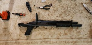

Just found out that the forward sleeve that tensions the barrel on the Ternion not only can be used to install 870 barrels but also is a built in tool for handguard removal. You can use it to unscrew the nut that holds on the handguard.
Ternion indeed works with 870 barrels as long as you get the version with the long pic rail. This one is my buddy's as i dont own any firearms, has a 14" norinco barrel from some other ancient 870 clone, conveniently the front sight matches the rear. OAL as pictured is about 28-30 inches cant remember exactly.
