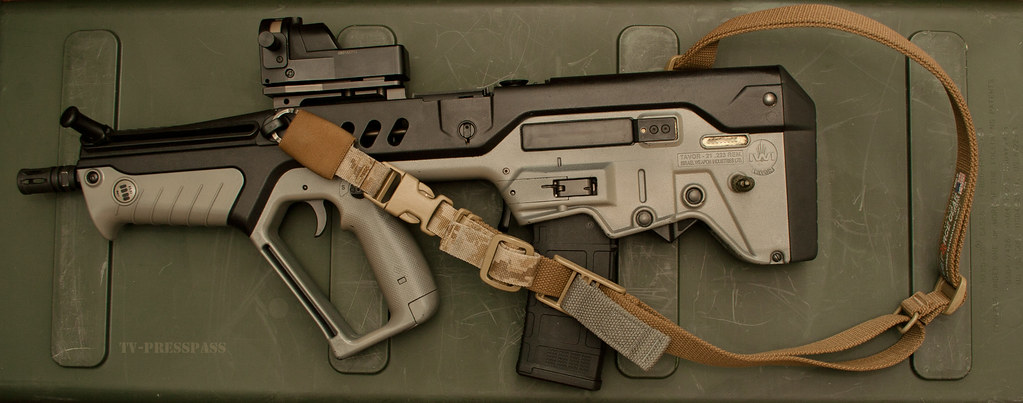

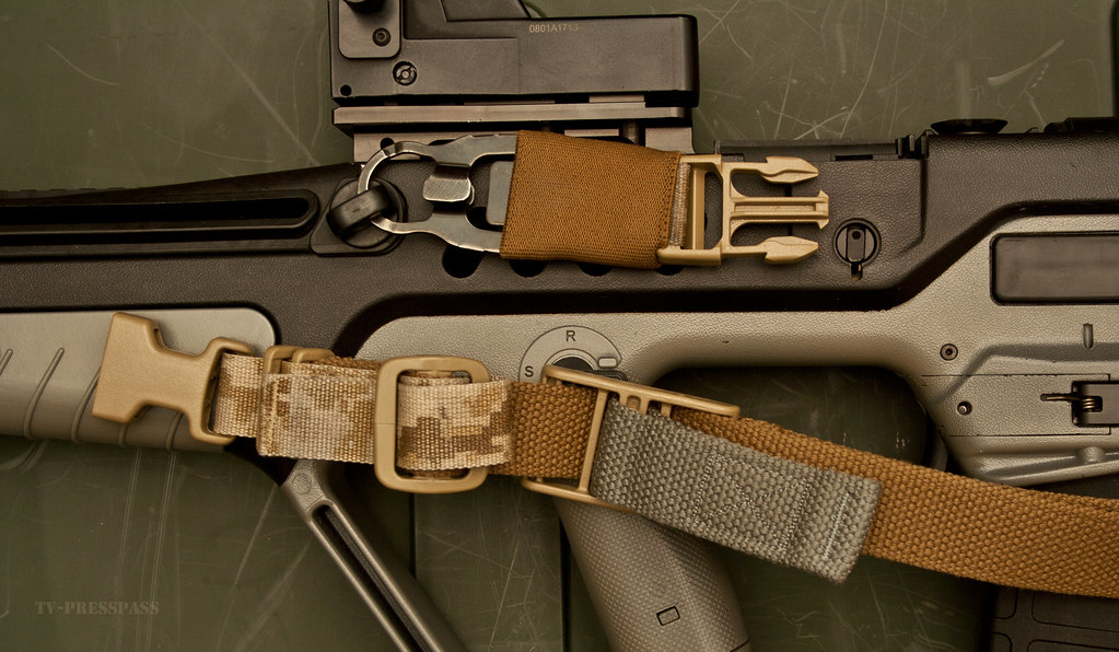

Dutch C8 - Sling threaded through the buttstock with triglide on the other side.
Push Button usd with Magpul CTR stock.
Push Button used on the front, wire loop used on rear.
Push Buttons, ladder locks and triglides on the buttstocks.
Push button to the opposite side of the stock with Rail Mounted Sling Loop up front.
VCAS used with our Push Button Triglide to create a single point sling. Push Button attachment into the cup behind the action.

Where are you getting that Tavor with the shorty rail on the top? I prefer that setup but am only seeing rifles for sale with full length rails.
Is it an after market set up?
Go back. Waaay back. Then buy all these crazy parts before North Sylva had even whispered IWI's name.
Its from . . . 2008? something like that. And yes, I generally get 2-4 emails a day from American's asking where they can buy one. As far as I know its out of production entirely.
