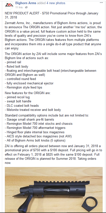

Not a single bad thing to say about the Bighorn. Love it. Will probably eventually do a short action build as well. Talked to Gary about the Bighorn Origin just before he left. Sounds like it will be about $3-400 cheaper than the SR3. Gary said Defiance is coming out with a lower priced action as well.

This action looks impressive.
I'll most likely be deciding between the Deadline and this Origin.
Hey All looks like ZAI has a new cut down version of the TL3 called the ORIGIN at a promotional price pulled this off their FB page. Pretty good price even with the exchange for a custom, Gary Eakins calling Gary! LOL.
