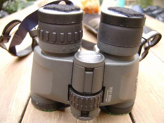

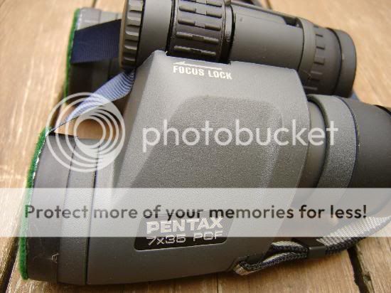

This one is a 7x by 35 mm Pentax PCF Porro prisms binocular and at 28 oz. not that heavy, Porros are always more bulky than roof prisms, but this particular model has good ergonomics and at 6” long by 5 ½ “ it is quite compact for a full-size glass.
This particular model have a focus lock on the focus turning wheel, when you have achieved the focus you can lock it in place by sliding the lock into place, very neat,
The right ocular has detent clicks in the diopter adjustment for the eye, another very neat feature that speaks attention to detail and innovation in the design.
While most Porros binoculars have a couple hinges connecting to the center shaft, these are designed with a more solid, all-body mass to center shaft, more like a quality roof prisms. I don’t see this binocular get knocked out of alignment by rough use anytime soon.
The glasses I have, had been replaced in the Pentax line for the new PCF WP II 8x40, and they are even better as they feature helical adjustment for eyeglass wearers instead of my old style fold down rubber eye guards, and I have noticed that they come with a rain guard for the ocular lenses tethered to the neck strap while my model has the easy-to-lose plastic caps.

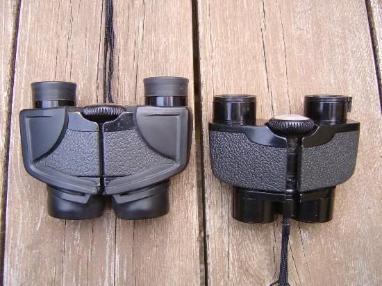

Here is a picture of them together so you can appreciate the size difference. From left to right: the Leupold Yosemite 6x30 Porro prisms, the Leuopold Katmai 6x32, the Nikon Monarch 8x42, and the Pentax DCF 8x42.

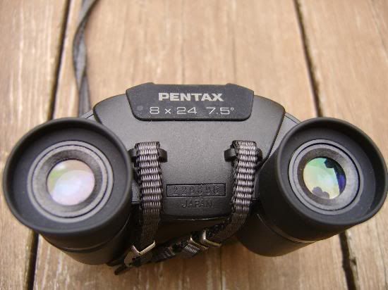

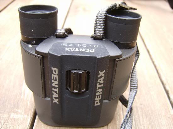

Take, for example, initiating my European vacation starting at London about ten years ago. I decided that I needed a small binocular that would fit into my already nearly full camera bag.
I found my price in Portobello Road, a small reverse Porro prisms 8x by 24 mm Pentax binocular. Perhaps you are not familiar with what a reverse Porro prisms is; in this class of binoculars (to make it compact), the designers invert the relation of the barrels and oculars. The objectives are actually very close together, and the big separation is in the ocular lenses.
The Pentax has the diopter adjustment in the right barrel, like other modern binoculars, this particular model comes very well coated with magnesium fluoride for good light transmission and the focusing of the binoculars is all done internally, unlike other Porro prisms, which means that there aren't moving parts that can bring dirt or moisture inside.
The unit is rubber coated and weighs 10 oz. My steel tape says that it is 3 ¾" long by 3 ½" wide. A well constructed and solid unit, as you can see in the pictures.
I haven’t seen this particular model in the Pentax line lately, but I don’t doubt that what they are putting out to replace it is as good as the model I have, which has been tested in many hikes and been under rain when accidentally left for two days hanging from a branch at the top of a ridge.

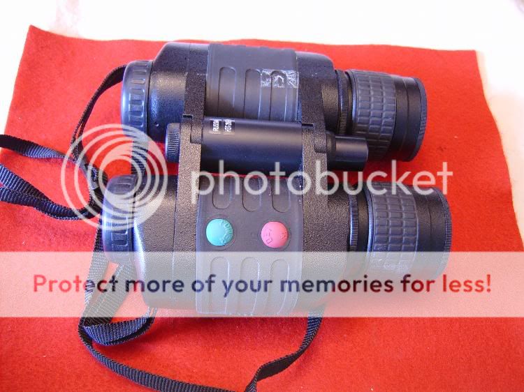

I have owned this night vision binoculars for about seven years. They are made in Russia and feature the first generation of Russian intensifiers tubes that are so popular lately.
It is my understanding that the Russian tubes were not of new manufacturing, but surplus tubes were released into the market. My first unit of these binoculars had a tube that was much dimmer than the other; however the Night Owl Company quickly exchanged them at my request.
As you probably you already know, unlike the older infrared night vision technology, the intensifier tubes do just that: intensify the light that is available (up to 30,000 times according to the instructions) and if ambient light is present, it doesn’t depend on the attached infrared emitter that is placed on top of the binoculars as an extension of the center pivot.
The binoculars enlarge the image transmitted to the oculars by 4 times. Not exactly a long-range pair of binoculars, but really very useful at short distances.
The Infrared emitter has a separate button for its operation. It is not really full infrared (infrared light is invisible) but a good amount of red shows out of the lens of the tube, making the fact that you are watching with them noticeable to humans. For game it really doesn’t matter, as most animals are blind to the red spectrum of light.
When used with a truly blind infrared powerful source (I just rigged a BOREALIS 1050 lumens flashlight ~2 million candlepower~ with a surplus Israeli jeep infrared filter) the binocular can easily “see” 300 yards away in total darkness.
The glasses weigh 31 oz., which isn't bad for a binocular that is 6 ¼ long by 6 ½ wide and 1 ¾ thick. The barrels of the objective adjust for focus individually. The adjustment is very smooth and easy to move; likewise, the ocular also has an adjustment that is individual to each eye, and it is not a center focus adjustment wheel, like in regular binoculars.
The metal screw in caps covering the objectives have a little pin hole to limit the amount of light that will enter if the binoculars are used during the day, which is mostly done to make adjustments for distance and focus previous to the projected night use. Those metal caps are noisy to unscrew or screw them, so if you're using them when game is near, I recommend replacing them with Buttler Creek or similar spring loaded binocular caps.
The power is supplied by a Lithium 123 3 volts battery that is loaded from the rear where the hinge is in the binoculars. These batteries are more popular than ever, thanks to the amount of tactical flashlights that make use of them.
This is better than the present problem I have of trying to find a number 1 battery for my Israeli surplus infrared night vision goggle (and by the way, if one of you readers know a source for such battery, please let me know).
For a first generation unit, the Night Owl 4x Compact is a very good binocular, well thought-out in its design and construction, with rubber covering to make gripping easier and to deaden game spooking noises. When I first bought them my son was 10 years old and interested in watching game, so we spent a few enjoyable nights watching deer eating apples at the tree and watching over a bear bait in upper Maine, just to see what was showing up. To all you fathers out there, those kinds of memories can last a lifetime and tend to be the greatest ones, especially when that same son is now a college student and interested in watching other types of game. ;) So cherish them well.
