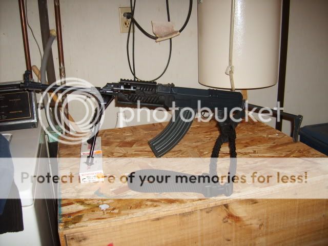

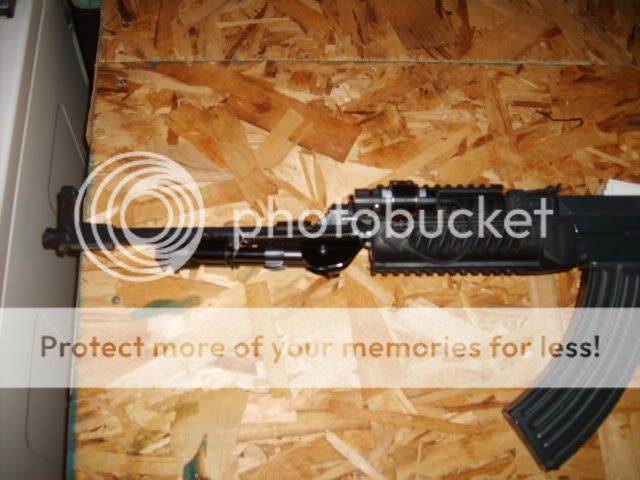

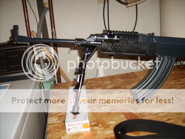

Thought I'd share my project.
I bought a Harris bipod the attaches to a sling swivel from a place going out of business. I figured I'd like to adapt it to one of my weapons. I decided I wanted to adapt this to my CZ. In the end, I removed the attachment pieces, drilled and filed the plate for days until I had the shape I wanted. I then fit it to the barrel under the gas tube at the front of the barrel where the port is from the inner barrel. I had an aluminum clamp plate from an SKS accessory that I no longer needed and with the help of a teflon half pipe from work I snugged it up to fit seamlessly. What I like is the low profile and the fact that it covers up the length of the barrel which I feel is more aesthetically pleasing. What I don't like is that the legs are about an inch too short. I guess I'll have to add some material, but all in all I feel it turned out fairly nice. Sorry if the pictures are a bit blurred.
Might not be what everyone is looking for, but I thought I'd share it.
