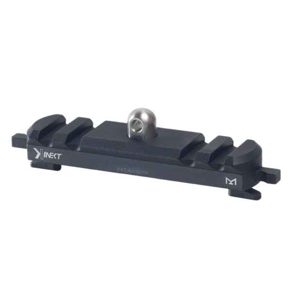

I attach my Harris bipod to one of these, then it easily locks into any MLOK mount.
https://kineticdg.com/product/kinectmlok-harris-bipod-mount/
