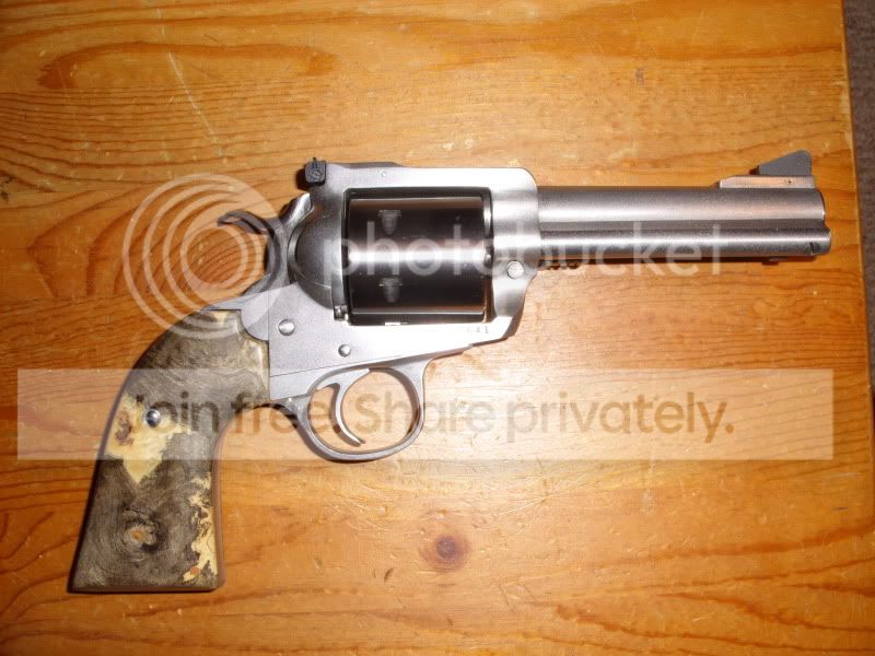

So I recently purchased a used stainless .44 Super Blackhawk from BJSGEAR here on Nutz. As soon as the package arrived, I took it down to the gunshop I deal with, and immediately set to work. I pulled the barrel off, threw it on the lathe, and cut it down to 5", and gave it a deep target-style crown. I then ordered all the parts to convert it to a Bisley from Midway, and had them shipped to a gunshop in Minnesota. A friend has an import/export license and deals with that shop, so he went down there and brought back the parts for me. I just finished installing all the parts, including a 30 oz. Wolff trigger spring. I will continue to post pics as the project continues. I purchased some gorgeous English walnut for the grips (check the pic), and hope to get those done soon. I also plan on beadblasting the gun, possibly with the cylinder left with a high polish, we'll see. I may also change the front sight to a barrel band style, I'll have to make that, though.

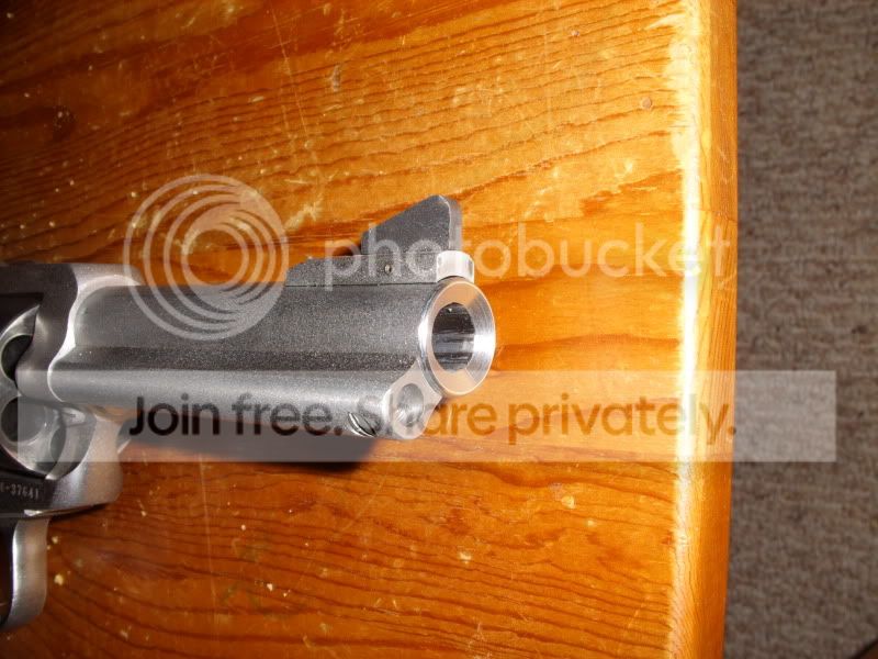

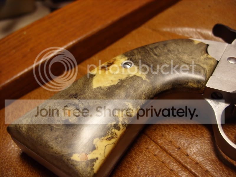

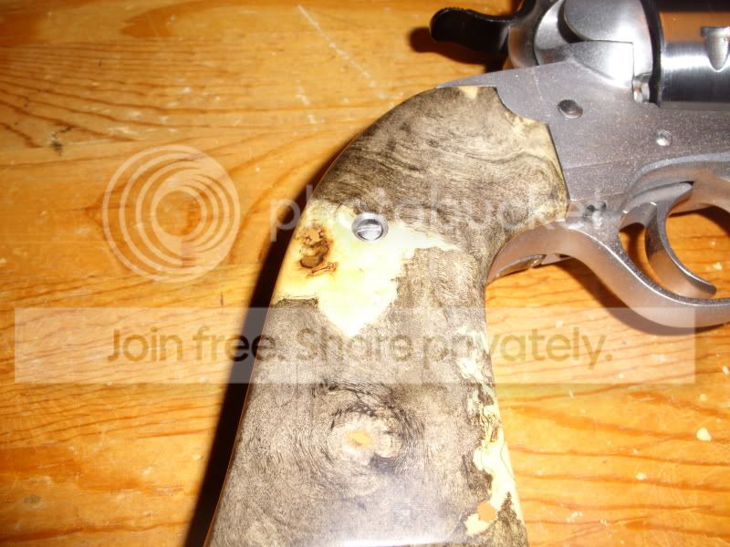

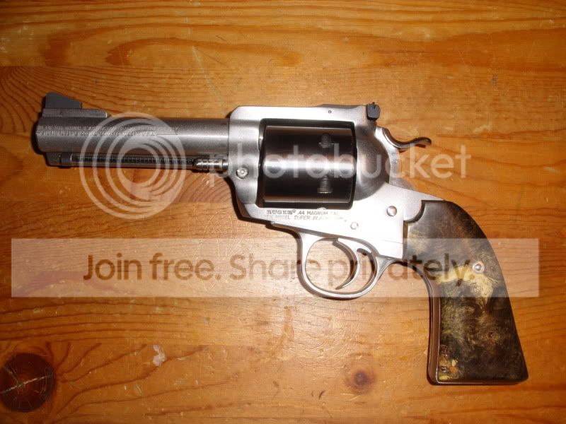

Well, I've gotten more done on this piece, finally. I had unfortunately installed the front sight a little crooked, so I wanted to fix that. I cut the barrel again down to 4 5/8" and reinstalled the front sight, this time properly. Also, I finally got the grips done. I was going to do them in that really nice piece of English walnut, but it got lost in the mail. So, I made the grips out of Buckeye burl that had been stabilized. I think they turned out really well. I put many coats of lacquer on them, wet-sanded with 600 grit, buffed with rubbing compound, and then polished, all by hand. I had to make the escutcheons on both grips, and I made them out of stainless. The last thing to be done is that I am going to have it professionally bead-blasted, except for the cylinder, trigger, and hammer. What do you think???
Nice work. That walnut looks like expensive jewellry! It really sets off the gun too. So now all that's missing is the range report on how well it shoots.
