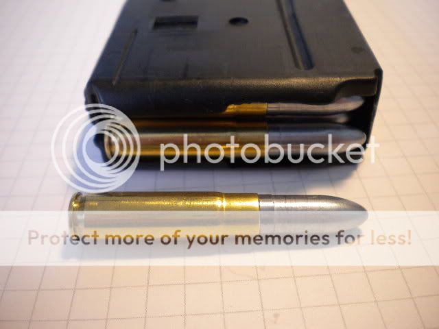

That looks like the very same bullet I am using. However I can't seat mine close to that long
I searched for NOE 311299 and that is what it came up with. Notice how the front half of the bullet is actually under bore size so it can go up into the lands without touching them. The lands will only touch the stepped portion just ahead of the case mouth.
That is correct. The nose will ride the bore and the driving bands grab the rifling. It seems the NEA chamber has no throat. I can't have any of the stepped portion protruding from the case mouth
Keep in mind your bullet is .003" oversize so it will engage the rifling sooner.
I just talked to Jeff about this and he tried dropping some factory ammo into one of their barrels and it went in and out fine. If SAAMI spec ammo will drop into the chamber without getting stuck then the chamber conforms to the SAAMI spec.
I have some .308 sized bullets not dissimilar to the ones you are using and I am able to seat them out even further than in the pic above.
