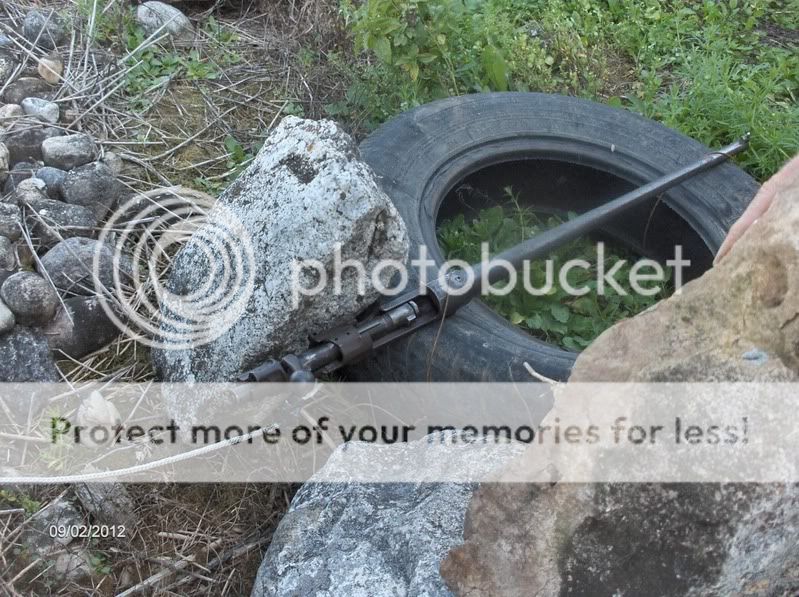

Obviously doing this was inherently dangerous and I don't recommend anyone try this at home. It was fired remotely with a string and I was well protected by several inches of steel. The barreled action was behind a large gravel pile. Several fragments of the barrel were never found.

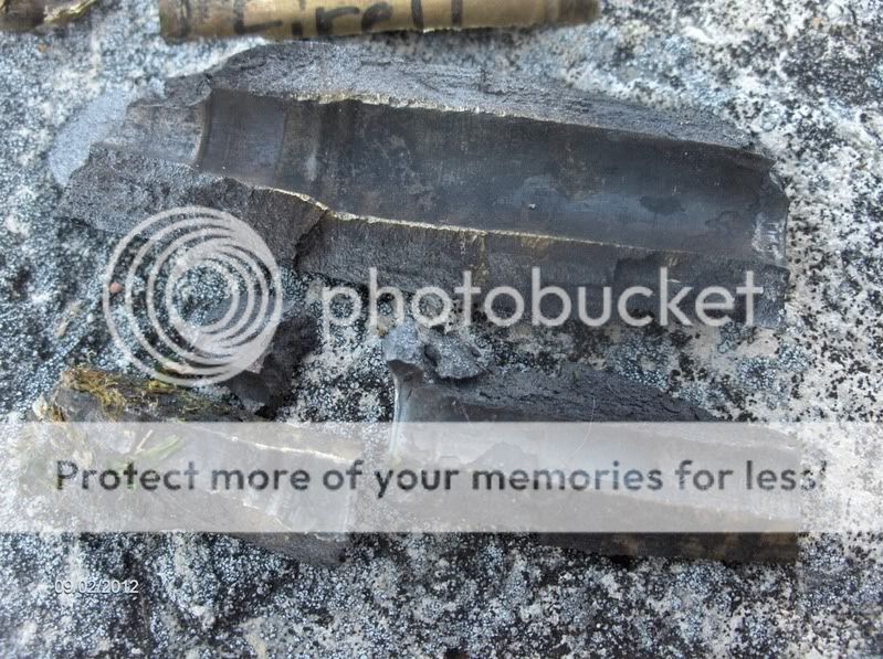

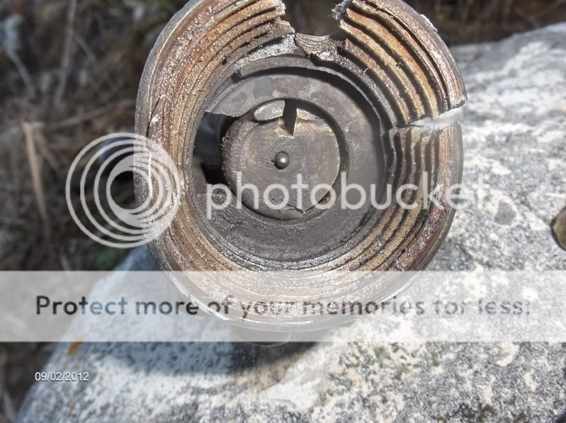

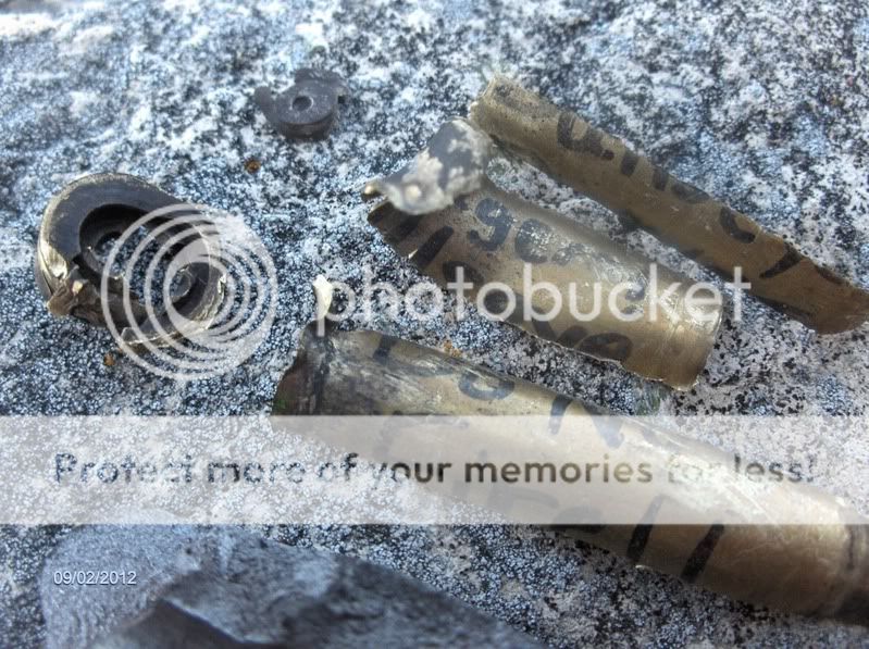

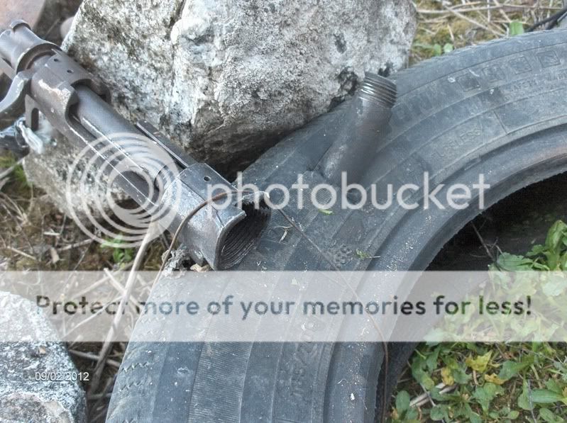

It is interesting that even though there was some pretty serious setback of the reciever locking lug areas, the bolt held. The bullet is lodged in the barrel about half way down.
Here it is mounted in my highly scientific test platform.:p
Here are a few pics of the aftermath. Notice the piece of the barrel stuck in the tire, the neat "cutaway view" of the chamber and the mostly intact action.
Well done sir! It proves that your fire-damaged mauser could not hold up to a case full of Bullseye behind a bore obstruction, but it also shows the possible path of destruction that could ensue. Great pics.
