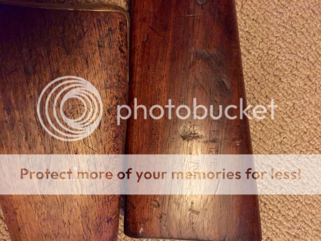

Greetings . I have an 1893 Mauser 7x57 that has the British broad arrows facing each other,Which I am told is a captured rifle. It has wood that is amazing , barrel is sharp and bright, totally matching numbers .The stock also has initials carved into it , which apparently was common for the Boers to do. Here is a bit of gun #### for you Mauser/ Boer War collectors . Cheers.

Beautiful rifle. The DWM on the receiver, vice Ludwig Loewe, tells you that it was made toward the end of the 19th century. My carbine, part of a contract from August 1897, was made when the company was called Ludwig Loewe. The receiver has not been 'scrubbed', as Boer contract rifles and carbines were made as 'anonymous' as possible. They often had a cryptic cypher on the left or right-hand side of the rear of the butt, as your clearly has, and a repeat of the serial number on the wood immediately below the one stamped on the receiver, but I can't see it on your photograph. I'll let real experts discuss your nomenclature.

I won't say it is or isn't a Boer Mauser. I have owned a couple and I have never seen initials so poorly done. The ones I have seen and owned were rustic to incredible. As for the capture marks. They may also be sold out of service marks.

I have examined Boer Mausers unmarked, crudely initialed as with a nail and elaborately carved approaching folk art.
Have a good look at the condition. I think it may have been captured early in the war and taken home to Canada by someone here. The rifles with the carving and elaborate names etc were done over long periods of time . Creative moments when boredom sets in.

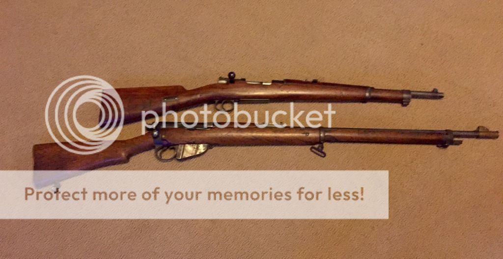

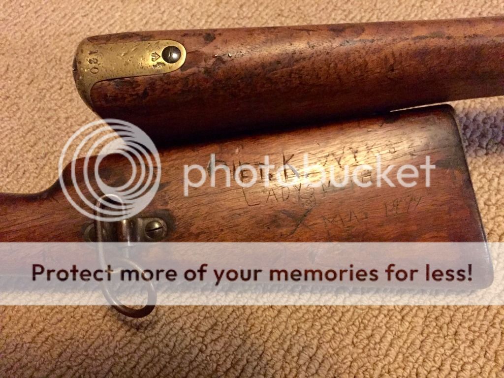

Here is mauser carbine and a 1896 L E 1 that I bought as a pair. They belonged to George Francis Salmon of the 2nd Battalion of the Canadian Mounted Rifles. The enfield stillhas the sling swivel use by the CMR. It is M&D marked above the rondle. The mauser is #6819 all parts matching ecept bolt which is from a rifle. There is a name carved into the stock PIET.K.WYKUS [last two letters not clear] Underneath is LADYSMITH XMAS 1899. On the otherside is GOLLSBURG FEB 1900. The places and dates seem to be different writing than the name. Mr. Salmon died in 1953 so no way of proving anything,but the guy I bought them from said the family said Mr. Salmon brought them home from the Boer War. The man on the horse is suposedly George Salmon.
What a wonderful collection of objects to own.
Great envy is mine!
The name is probably Wykhuis or Wykhujs - the i and the j were interchangeable in the Afrikaans spoken at that time.
