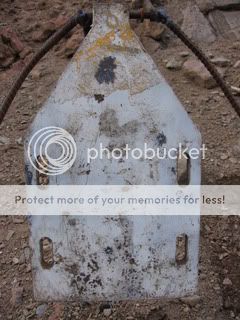

Try a 1:8 twist T3 Varmint. I've got a $240 Vortex Crossfire 6-24X50 on mine until the Viper PSTs show up. The first time I'd shot it out to 1000yd was last weekend when I put 7 out of 20 80gr Amax onto a 10"X14" gong in a 10 mph 1/4 value wind. I still can't wipe the grin off my face.:dancingbanana::sniper:
