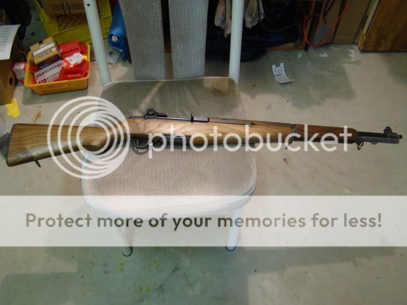

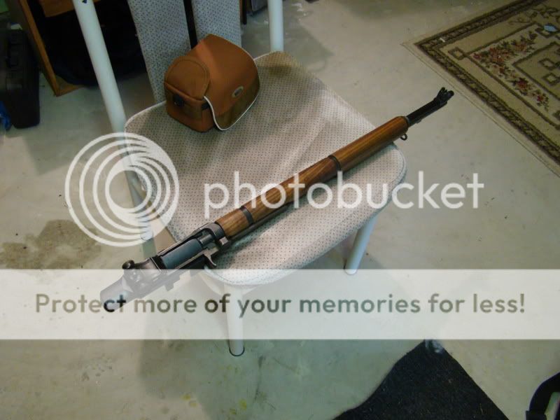

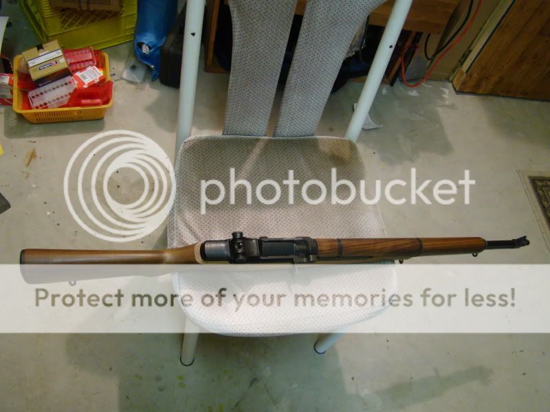

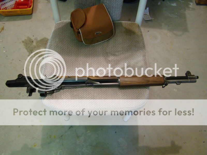

I got the metal together but I put another "coat" on the stock as I could see a few spots were it soaked in over night and looked patchy.
I also used steel wool to get all the rusty spots off the metal and cold blued it. Looks 110% better than it did before, it was really, really pathetic when I got it. I payed too much for it but it seems M1 Garands are in high demand nowadays.
He is what I got so far.
