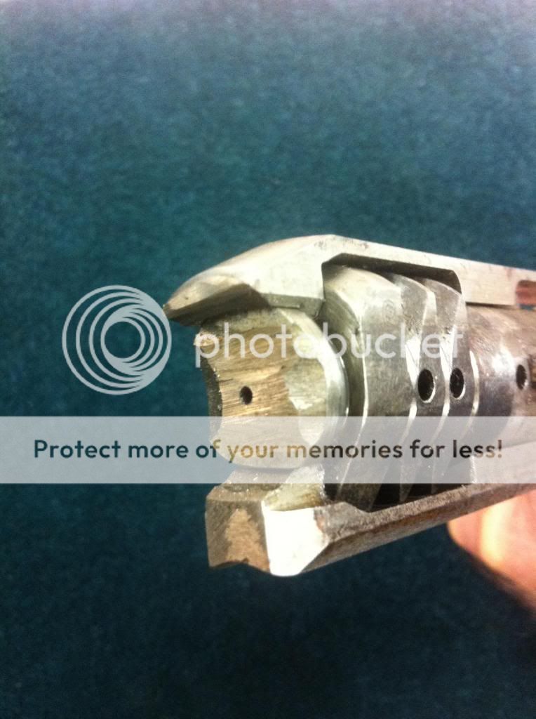

I have discussed this rifle a few times, but I finally found an original .55 barrel, so this project rifle is close to breathing fire once again.
The only problem now is the bolt. The bolt face was ground, so I need a new bolt, new bolt body or maybe I can repair the bolt.
One gun smith told me that a good welder could rebuild the front the bolt face. The second option was to cut the damaged bolt face off, tap the bolt body, manufacture a new bolt face and thread on the new bolt face. These two options sound easy enough, but does anyone know a capable gunsmith who could complete these modifications?

A lot would depend on how much grinding was done. Could you post a photo?
This would determine whether replacement, a mechanical or welding repair would be best.
Given that the locking lugs are right behind the boltface, welding would have to be very, very well done to avoid altering the heat treatment of the lugs. I suppose a first class TIG welder using heat control paste could do the job. Jason, at Gunco in Nepean, uses a really good TIG welder.

Pics finally - I know the extractor and ejector are FUBAR, but I can find those parts:

If it were my project.....
First choice: New bolt.
Second choice: Turn the face flat. Drill out the firing pin hole. Cut fine threads. Make a new boltface with a threaded shank. Screw into bolt. Set with permanent threadlocker. Drill firing pin hole. Face to adjust headspace.
Load in firing is linear. A new boltface would be under a compression load; there shouldn't be a safety issue.
i think marstar has the extractor and ejector(they also have a head space gauge) but that bolt face is done why someone did that is beyond me
id do what tiriaq says just make sure you make the thread tight tolerance with not much play
I'd repair the bolt especially if it is numbered to the rifle. A new bolt, if one could be found, would need fitted. IMO and experience repair procedures exist for such work. It would be worth exploring with any shop the does die repairs. These are always brought back to originally surface specifications by welding, machining and polishing. You have nothing to lose by going to a skilled professional. It going to cost a few $'s however you have a very unique rifle. Ron
