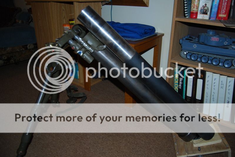

Here is the one I am working on. Its a original Can m5 mortar mount with a new barrel being made. The top barrel will be the firing barrel and the one locked in the mount is just a display tube..
