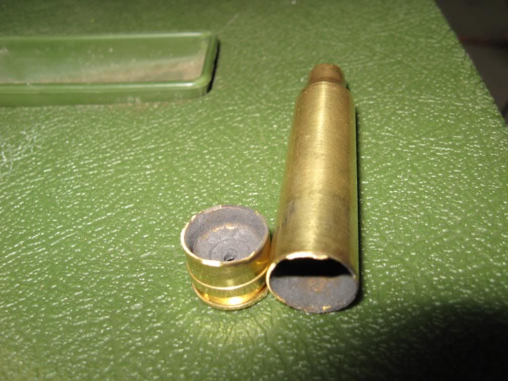

If you look at Blacksmithden's pictures you will see a lot of things. First you can see the line where the die stops sizing the case. You can see the line from incipent separation, and if you look closely at the last blown up picture you can see a real nice false belt forming above the belt on two of the cases.
What exactly is it that you are seeing on your cases? While I don't deny that we hounds are having fun barking up three different trees, I doubt that it is helping you much.:D
My bet's on the false belt, slightly higher than the one in the picture.
