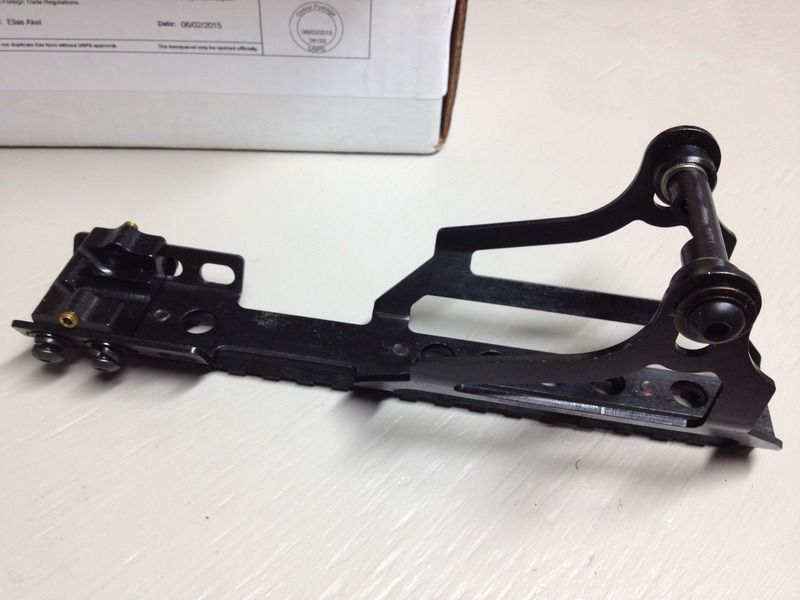

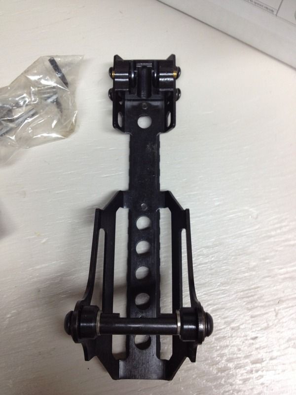

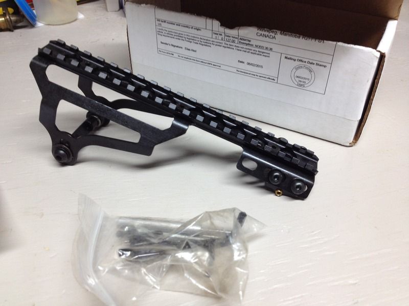

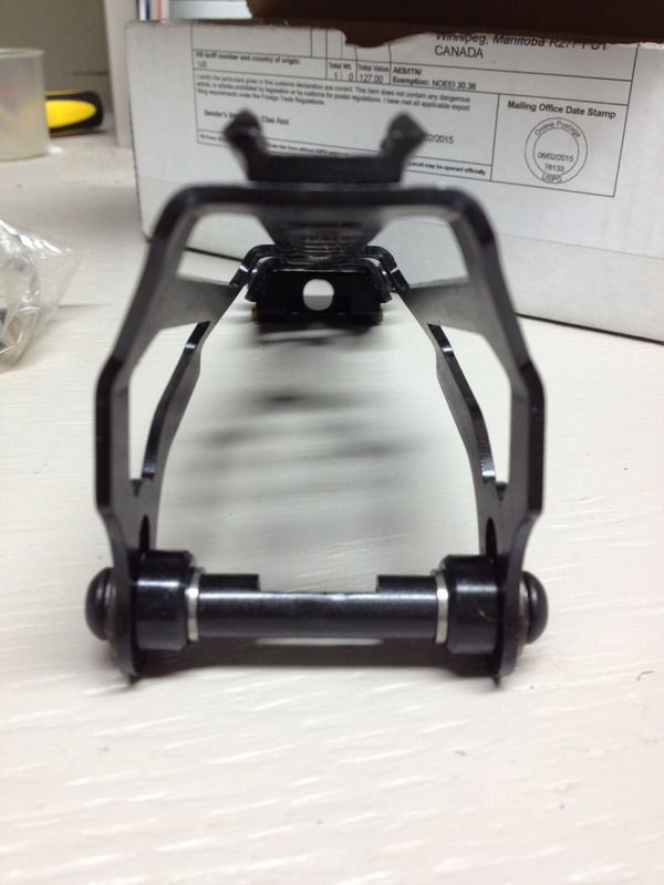

It HAS arrived !!
First impression... feels SOLID.
Installation will occur (with pics) this Sunday !! LER scope will be installed next month at the cottage (once I'm on holidays).
You can still use the iron sights thx to the peep hole.
Is it just me or does this look like a Klingon Bird of Prey ??
