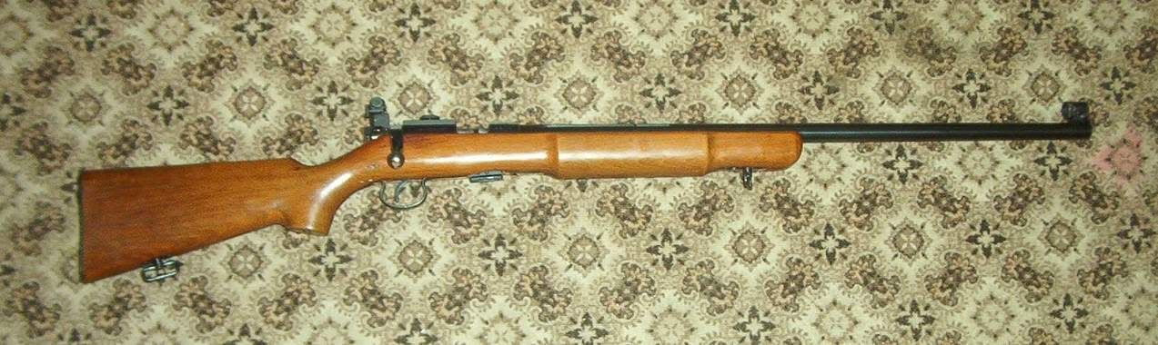

I have owned a #3. I got better scores in benchrest competition than any of the 452's I competed against, even the modified ones.
The #4 is an improved #3.
The 452 is very similar to the #2, and those with #2s claim they are more accurate than 452s. I think the #2 and the 452 are probably pretty close in accuracy but the #2 is likely to be more nicely finished and have a smoother working bolt.
I believe it is a slam-dunk that the #4 would be more accurate than the 452, or at the very least easier to shoot accurately.
The #4 is a lot bigger and heavier, with a much, much better trigger and much better sights and a longer sight radius. The bolt is slicker and seems to be machined to closer tolerances.The stock on the #4 is huge and rides the bags much better than the American and arguably better than the Varmint.
Basically the #4 is made to be more accurate than the 452 in every respect. The #4 is more similar to an anschutz 54 than it is to a CZ 452. Even if all other things were equal, the much heavier #4 would shoot more accurately than the 452 on weight alone.

A brno #3 or #4 for target shooting at paper would be the choice. Same trigger but only likely needs adjusting to your preference. With sights as pictured and the way it sits a bag you won't go wrong.

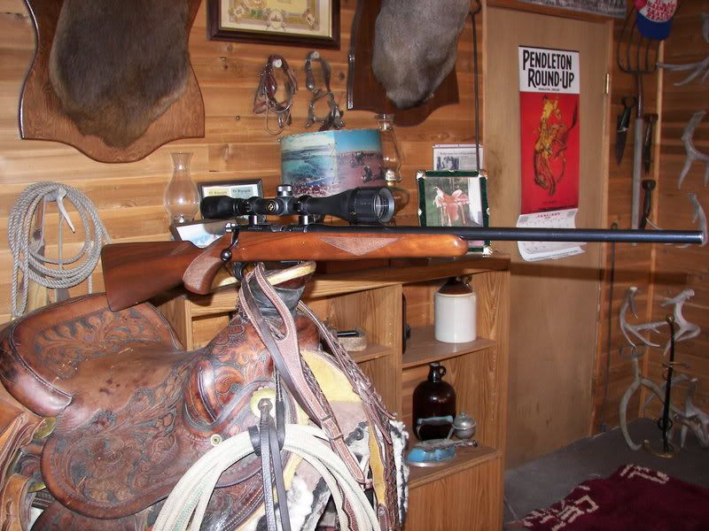

Brno's are much more abundant in Canada then in the States. Like the others have said I would look for a #3 or #4. I have the 4 and it is a solid rifle. I found that it is a good hunting rifle as well. Hunted (walked) alot with it this past fall without any grumblings of it being too heavy. (mine was scoped)
The sporter weight Brno #1, #2 and #5 make awesome hunting rifles too. You can easily hit chickens consistently in the head at 80 yards with no alteration to the gun except maybe adding a scope. Nothing wrong with using a CZ like an American, Lux etc. because they're plenty accurate too! I agree with 581 on the old gun/old world workmanship of the Brno's though. Personally I love those gun's!!! I must have more!!!
My Brno Mod 4 is the most accurate rifle I have ever shot, and the quality of the machining and metal finishing is excellent. It even makes me look like a good shot. Best group (benched) .3 at 50 yds for 5 rounds with irons (peep). I haven't had it out since I mounted the 6-24 Elite, but given it's accuracy I didn't think the scope was excessive.
