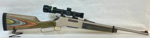

I've been reading some reviews and people say that the best grouping was 1.25" at 100 yds which is kinda not very impressive. But the 20+20" takedown compactness and stainless steel sound very appealing. I want a good backpacker rifle. Bad weather happens and I hate the need to dry and clean my rifle when getting home tired.
Also, there are few things to consider. My eyes aren't young anymore, so I appreciate optics/scopes. But this can ruin the idea of compactness. I don't think a red dot option could open the potential of this rifle. But as far as I know there are "quick detach" style scope mounts? Does anyone have experience with those? Wouldn't such a solution ruin the accuracy even more? Otherwise, maybe there are some good shorter scope options? If it extends beyond the rear piece only for max +1/2" forward then I could probably go for it. Any other ideas? Again the possibility to put it into a backpack is most important point for me.
Triggers can be horrible

Overall I don't see any other good take down alternative in hunting calibers ...
The best optic scope choice seems to be Leupold VX-3HD 1.5-5x20mm - it is 9.6" long and 14.3 oz -- does anyone have experience with this one? How bright/clear it is?..

i.e. if Leupold VX-3HD 1.5-5x20mm or Mark 3HD 1.5-4x20 Illum FireDot BDC is 9.5" in total length then how much would it outstand when rifle is broken in two pieces? Also, would it provide a comfortable eye relief?
The LOP of this rifle is 13 3/4" which is kinda slightly less than I normally need ( 14.5"). I think I could fit a 0.5" spacer under the butt stock which is again a length increase... So if scope outstands for about 0.5 then another 0.5" - this will make the rear piece to be 21" in total, so I would need a larger backpack to carry it comfortably. Yeah, the takedown is whole reason for me.
Like siad earlier here, there is QD rings option which can save my arse. But can also ruin accuracy, perhaps to not a critical degree, still...
Or I should try an aperture sight. If this is a techincally good solution for out to 300 yds then it would be great.
Takedown with a red dot on board makes sense for me. Takedown with a scope did not.
I fooled around with all kinds of site options on the takedown BLR - open sights, peeps, scout scope.
Eventually settled on a standard (receiver mount) picatinny rail. Can mount just about anything to that, and it offers really good fore and aft mounting flexibility to setup eye relief
A good set of rings will allow easy removal and return pretty close to zero when reinstalled. Seekins are my favorite. Nightforce Ultralite is another good option.

Great rifle, love it I have 3 BLRs. 2 are takedown.
Here is my baby on duty.
