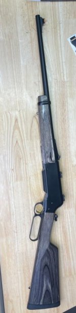

Yeah I took a pic. Please see the 2nd pic below. The two darker spots - were already there by manufacturer. You can choose to remove those if you wish and put your own fresh putty in. I left them 'as is' as reference points.
