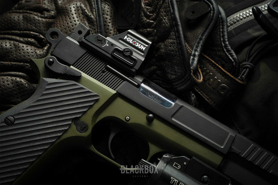

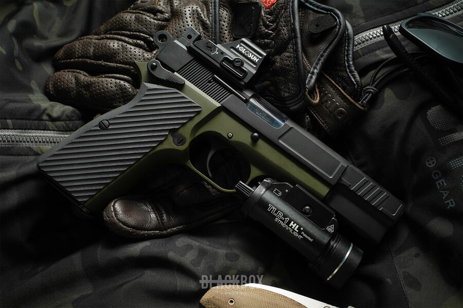

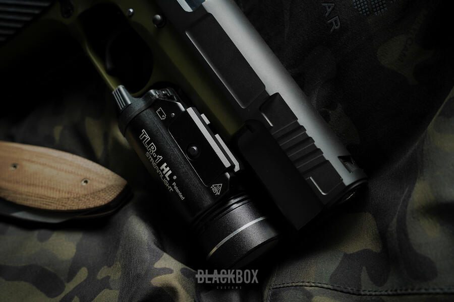

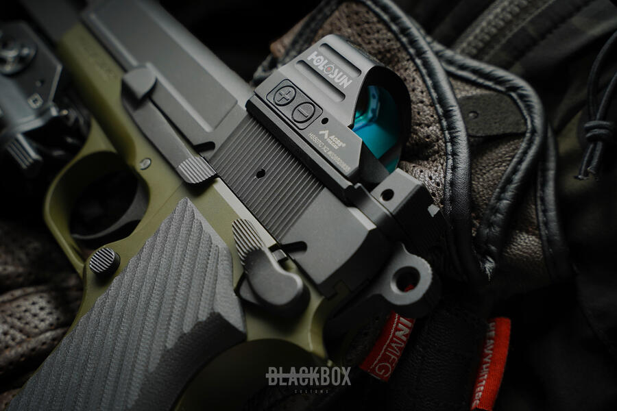

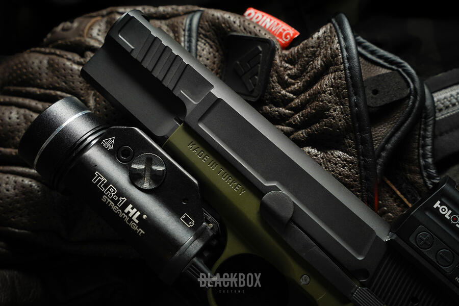

As proof that you can teach an old dog new tricks, our Custom Shop embarked on a journey to see if we can give the classic Browning Hi-Power a much needed update. We took a Girsan MC-35 BHP clone and created a modern take on the legendary Browning Hi Power design. First we performed an optic cut to mount the Trijicon integrated RMR footprint plate with built in rear sight. Next we took our popular Patrol slide package and tailored it to the BHP. This slide milling package has lightning pockets and forward serrations to reduce the reciprocating mass of the slide and to give the user more options for slide manipulation. Lastly, we designed a dust cover rail mount that can attach the most popular pistol weapon lights on the market. A modernization to a classic that can hopefully last another 87 years. If you have a BHP that would like a timely update contact us today!

How did you manage to put a rail on a gun that doesn’t come with it? Thats pretty sweet and I’ll probably send mine off to you guys for some work like that when I get it.

2) We low PSI grit blast and do acetone bake cycling to purge particulates and oils from the metal pores prior to Cerakote application.

We designed a low profile rail insert and milling that profile into the dust cover and installing it. Since there isn't much material to work with we decided to go with the insert instead to deliver the rail feature.
