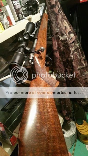

I have a friend with this in his gun cabinet. It's a gorgeous gun chambered in 284 win. It's a browning but says "made in Finland" I don't feel like uploading a dozen pictures, but I can email them. It has a Burris full field 2. Does anyone know anything about these rifles and a potential value? He wants to sell it but doesn't know if he should be asking 200$, 2000$, or 20,000$. I know a lot of different guns, nothing about this though.
It's a Sako rifle branded by Browning. Good rifle...I did not know they chambered them in. 284w

Back in the day, when Browning made all their rifles on FN 98 actions they felt they were losing some sales to other manufacturers because they lacked a short action for the shorter cartridges. The rest had all come out with short action versions of their most popular rifles to better fit the newer line of short cartridges based mostly on the then new 308 case. Browning, rather than go to the expense of tooling up to make a short FN Mauser action, contracted Sako to make them short action, barreled actions which they then stocked. Depending on condition will normally run between 1K-1.5K, but beware as some of the earlier ones were stocked with "salted wood" which caused extensive rusting below the stock line on these rifles.

Yes they were stocked by FN Browning and my understanding was that Sako supplied barreled actions to Browning's dimensions. This would also be borne out by the "Made in Finland" markings on my barrel.
It also makes sense because other than by hand on a lathe, Browning would have no way to thread barrels to the 16 tpi to match the Sako actions, as all their threading equipment would be set for 12 tpi for their FN actions. Not a big deal to you and I, but a real PITA when you're talking hundreds or thousands of rifles.
