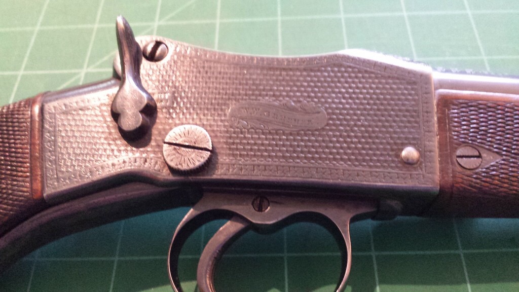

I know what your saying but none of mine do that, at least not to the extent you were describing, unless I really apply a lot of force to the cocking lever.
They just fall out on the bench within a foot of the rifle. When the block drops, controlled with the cocking lever via the tumbler, it drops onto the base of the leaf on the extractor, which causes it to rotate on the pivot pin.
Before the block gets to the bottom, the firing pin spring tops out and the rest of the extraction is controlled by the shooter, directly through the lever.
Likely one of the best extraction systems I've seen. Covers at least half the circumference of the rim.
