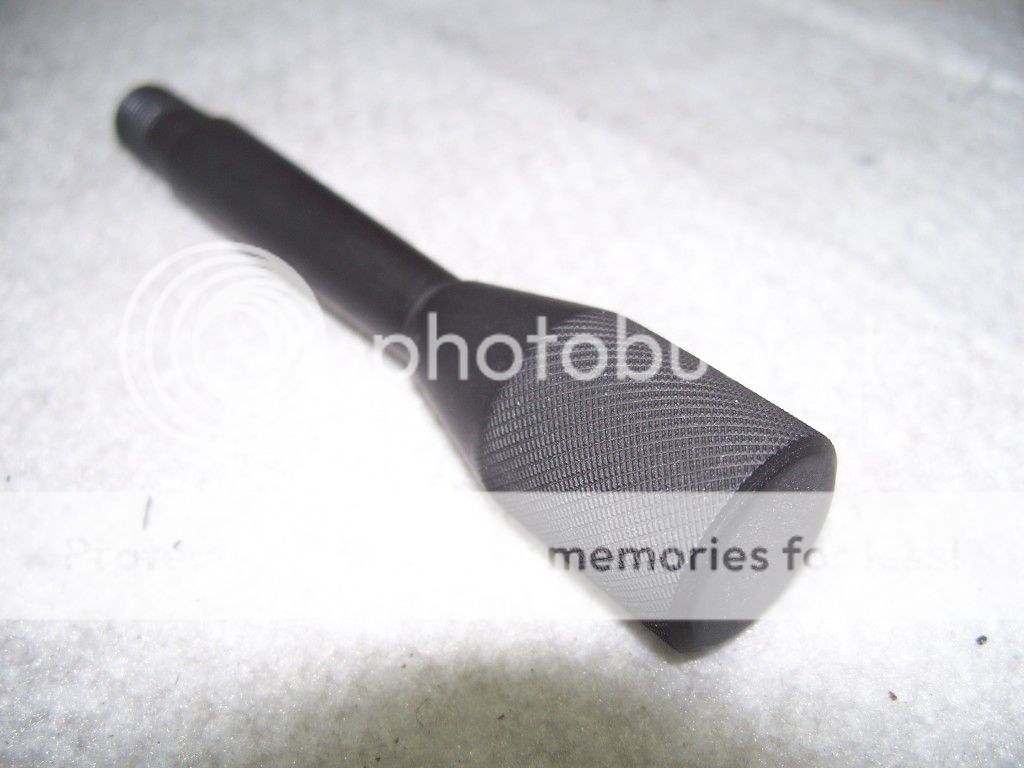

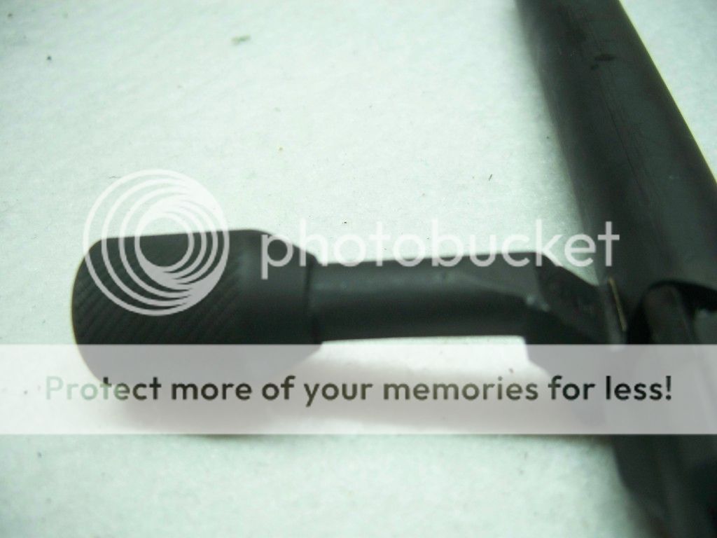

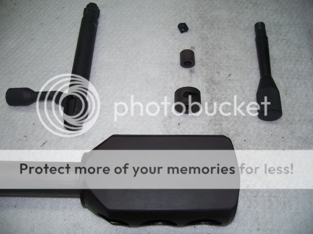

These are some parts I did with this home made brew
All of the above is inspiring. Nice work. That homebrew did a wicked job.
What part of a dry cell battery did you use? Did you use a standard cheap carbon battery, or an alkaline?
You can also get the phosphoric acid from a hydroponics shop. What? Don't look at me like that. lol
The manganese or zinc you can get from pottery supply houses.
Having said that, the solution you can buy I have found to give much more consistent results than mixing your own, YMMV
I was surprised with how black it turned out. You have to stir it from time to time to keep the maganese suspended.
