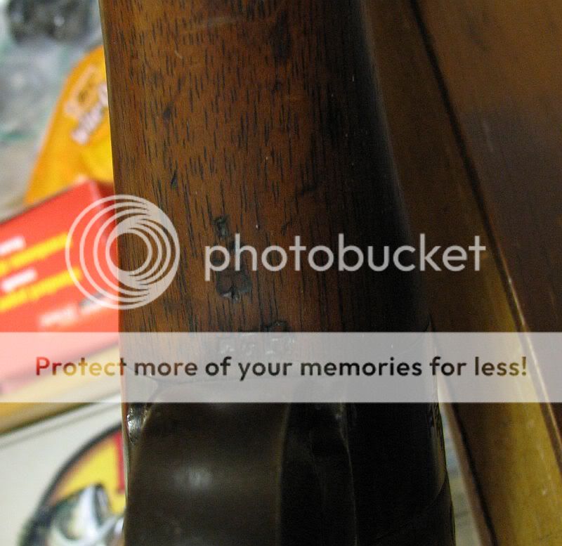

I just bought an 1893 Lee-Metford MkII. Unfortunately, Bubba got to it a long time ago. The barrel has "Alex Martin Glasgow" stamped on it, but it has been cut. The magazine seems to be correct. It has an odd spring set-up. The safety mechanism is gone. Here would be a pic of it before: http://enfieldrifles.profusehost.net/ri1a.htm

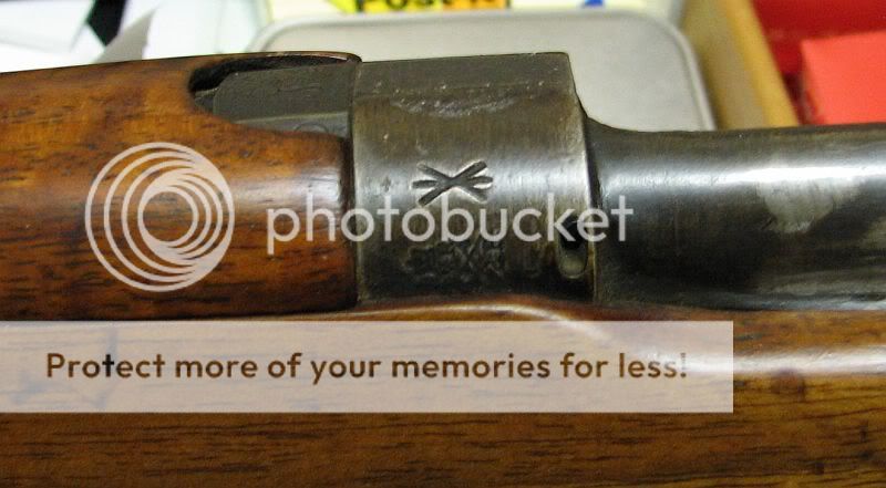

What might this represent?
http://i48.photobucket.com/albums/f214/kjohn73/LeeMetfordb###x.jpg
Your point-to-point Broad Arrows are the Army's "Sale Mark". They are proof that the rifle, once Government property, has been legally sold out of military Service and is not a stolen rifle.

I have a Lee-Metford Mark II myself, a commercial from BSA and it hae nae guid Scots thistles mark'd 'pon it. I rather think this could have been added in Glasgie.
I haven't seen your gun but perhaps you might have it looked at by somebody who really knows these old-timers. Martin's might have cut the barrel. Never know.

BTW, Lee-Metford Mark II didn't HAVE a safety to start with.
You used a combination of the magazine cutoff and the half-#### on your bolt. Safety catch (the 'wing' type on the cocking-piece) was introduced with the II* and continued on the Lee-Enfield Mark I and I*. Your rifle has no * that I can see, so never was fitted for a cocking-piece safety.
So she's completely original except, possibly for the civilian cut on the barrel, which could be the work of a VERY expensive guy.
