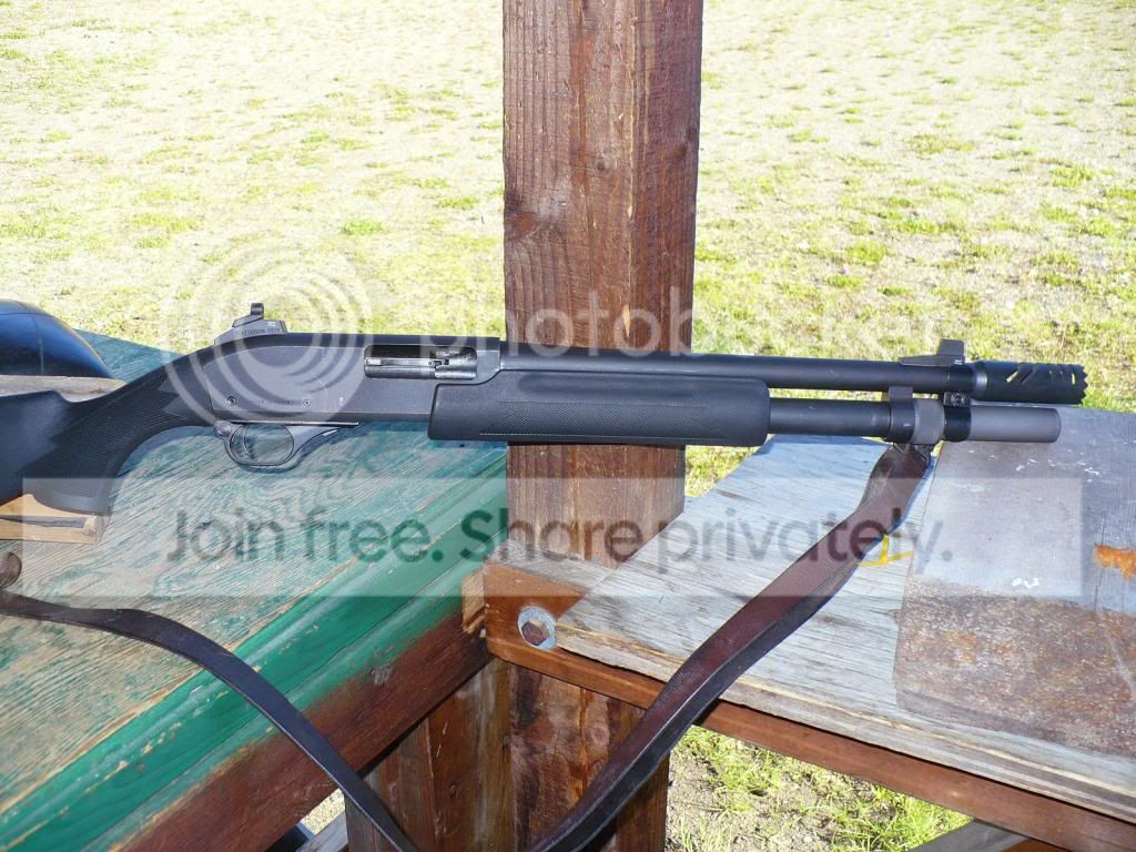

I'll be shooting them out of my Norinco HP9 12" pump. It's got Scattergun Technologies ghost-ring sights, so hopefully I can hit something.
