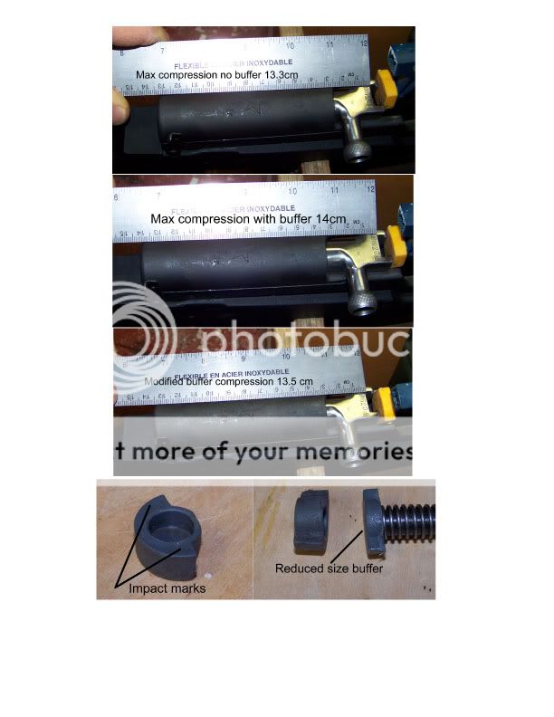

The body cover "recoil buffers" short stop the rearward movement of the carrier which then actually puts energy into the body cover when the carrier hits the buffer which you don't want. The spring absorbs the rearward energy and slows down the movement of the carrier. I haven't checked the receiver "H" ones yet but I'm sure they will short cycle to.
The reduced buffer size was a test and may or may not do anything at all except hold the spring nicely.
