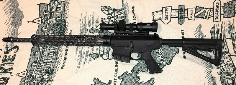

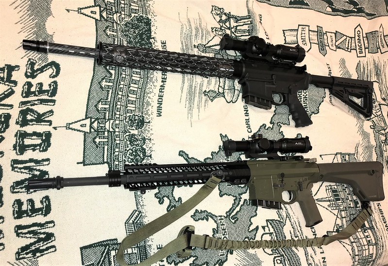

Well, the build is done. Almost time for a BCL 102 vs Stag-10 showdown ....
The 1+ lbs weight difference is noticeable.
8 Lbs and 6 oz with the Optic
What's the bare weight without optic, how close were we with the upper and lower receiver set guess from a couple weeks ago?

Updated with information received so far. I got out the scale and measured a couple of these parts as well [BOLD]
I hope the parts arrive quick!
Component
Weight (Oz)
BSF Barrel31.10
Stag 10 Upper/Lower Combo36
Flash Hider
2.90
JP BCG
12.96
JP Buffer8.0
Charging handle1.50
Handguard
6.30
Gas Block
0.8
Buffer Tube & Nut
5.10
NEA Buttstock
7.9
Gas Tube
1
Total113.56
7.10lbs
