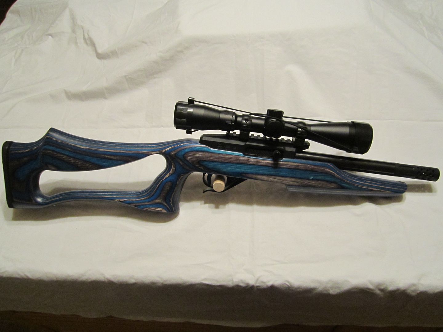

2) when your building a 10/22 usually you build them with a purpose in mind. i say this because i have 12 of them and each of them i build or tweaked specifically for something. be is bench gun, gopher gun, pack gun ect ect.
3) building a 10/22 is expensive! while i too would like to build my son a $1500 10/22 for his first gun thats like me giving him a turbo'd mustang for his 16th birthday instead of a 2007 Dodge Caliber.

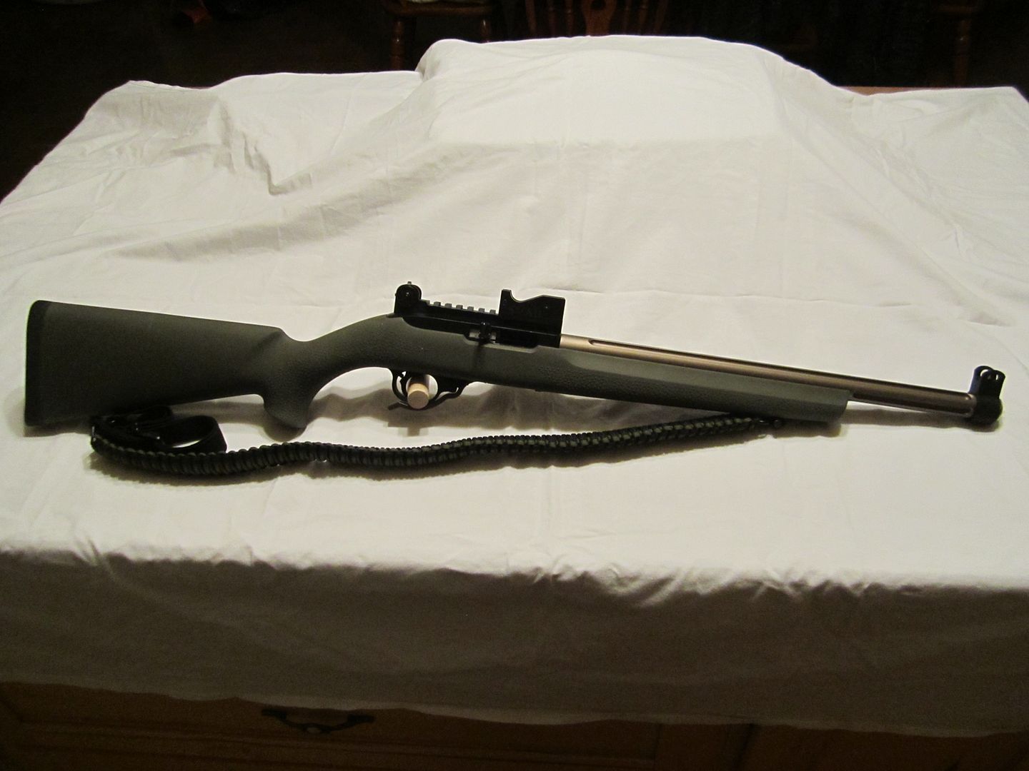

i know i have a Boyd blaster stock and a dlask 8.5" barrel and its just a hair over the minimum.
TacSol makes a uber light barrel, married with the Hogue stock the entire gun is light as a feather.

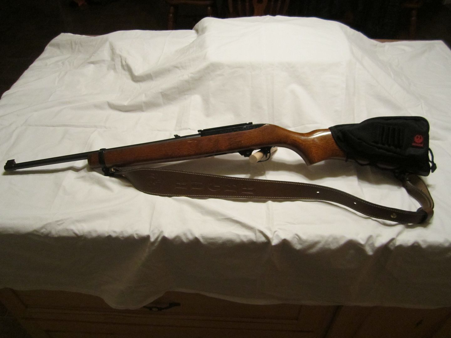

nothing wrong with a stock one, this is mine from 1984, the stock barrel is nice and light.

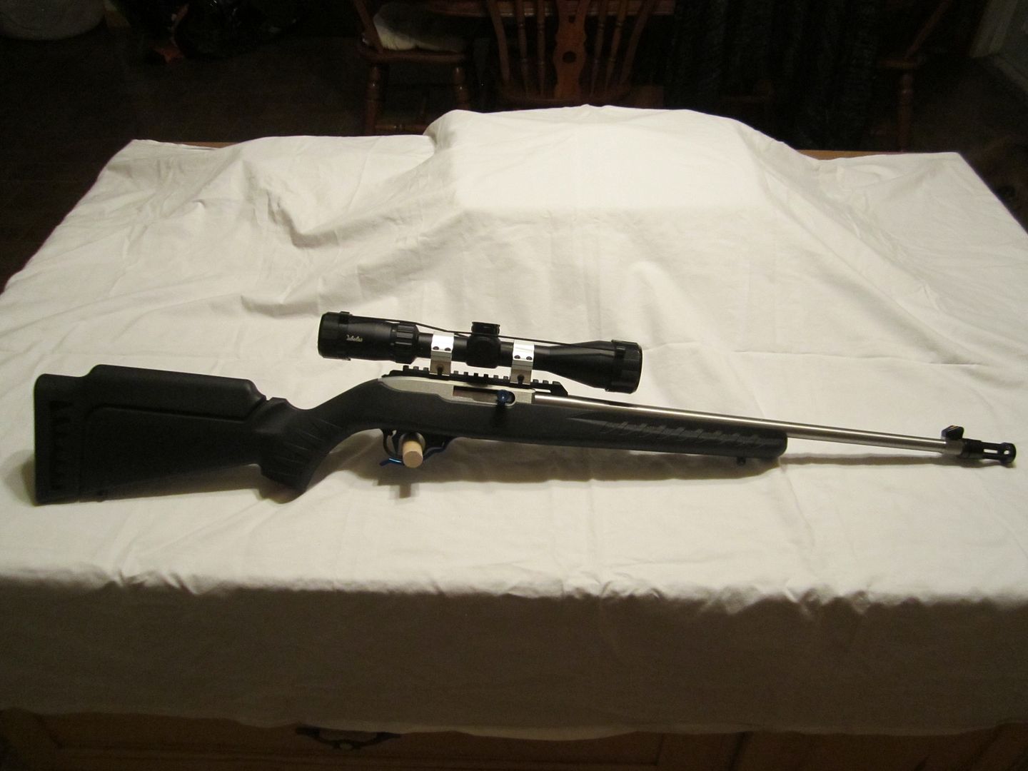

could always go cheap cheap and look for a RIA knock off and pick up a ruger stock off EE, they are not very accurate guns but they are fun!

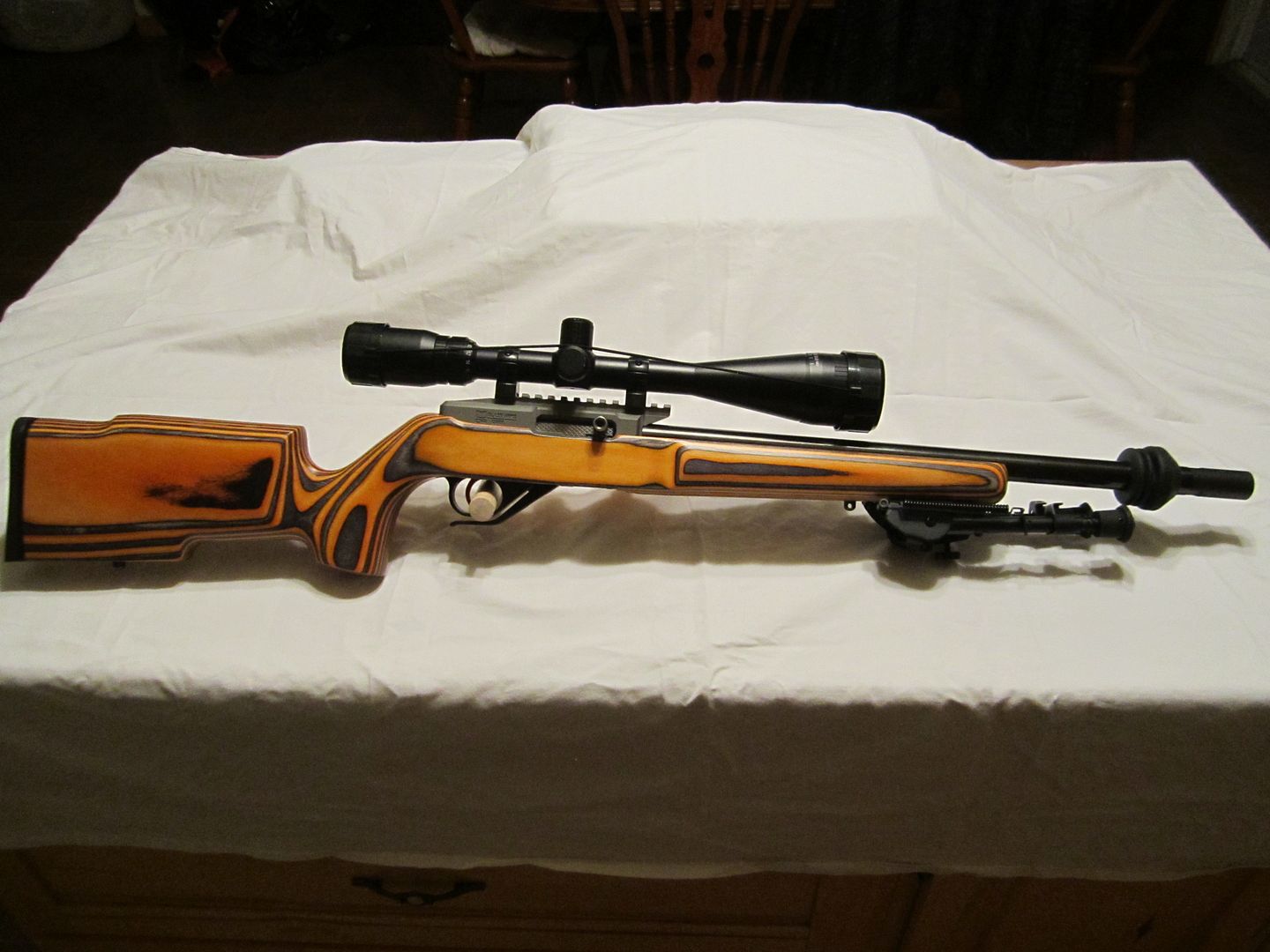

bench gun, heavy!
there are always special edition 10/22's that are out, like this 50th Anv contest winner, couple tweaks like a Brimstone strigger group and its a beauty.

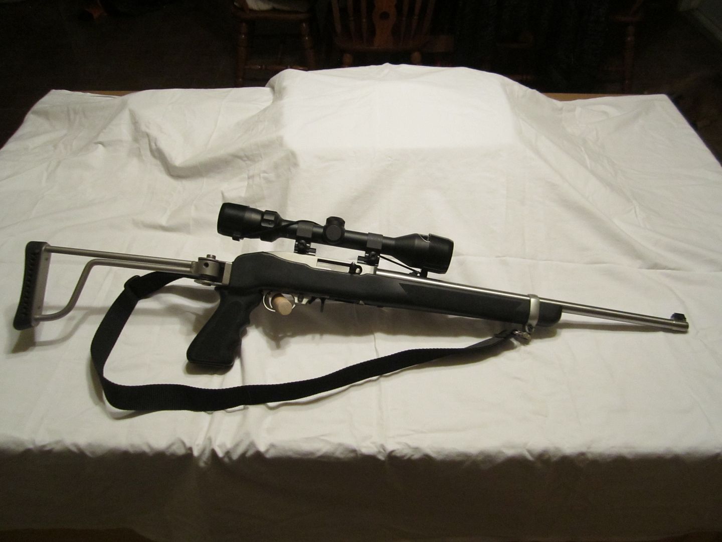

you could go mid 90's and flesh out a Butler Creek folder
