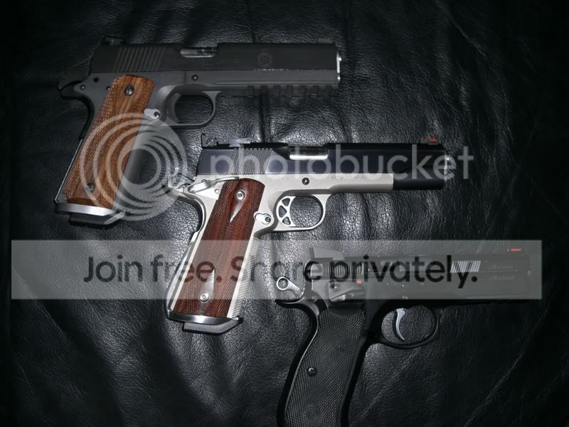

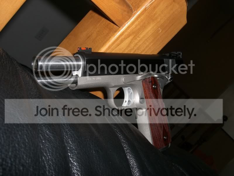

Just to prove it can be done, here's a few pics of my Norc NP-29 (Government lenght ) courtesy of Gunnar of course :D Too many upgrades to mention, but the point is that you can build a top of the line 1911 using a Norinco Frame which is forged Steel that in my opinion is much better then these light alloy frames swarming the 1911 market.
Just my 2 cents :) Someone had to mention it...
Pictures just don't do her justice. My next 1911 project will be again wil a Norc frame ( Commander ) and try and re-create an Ed Brown Kobra Carry Bobtail :stirthepot2:
