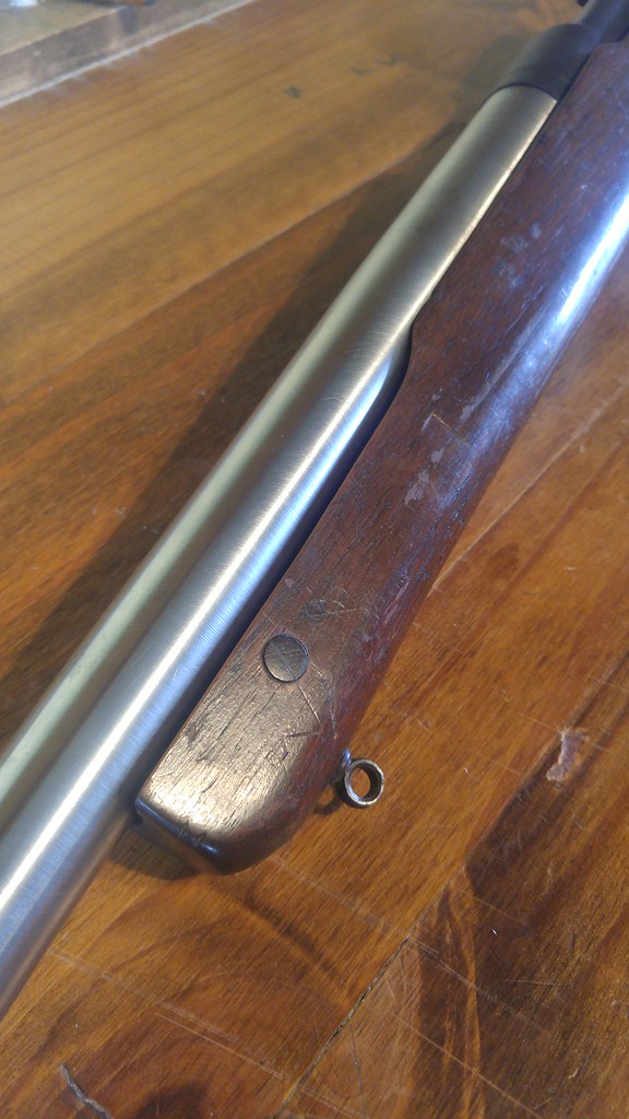

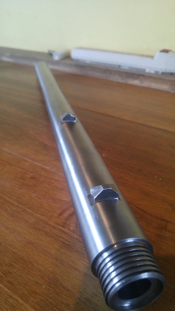

i had to sand down the front of the stock as the barrel is wider then the stock itself at the muzzle. i also profiled the recoil lugs a bit nicer looking.

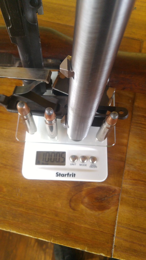

it holds 3 in the mag but i cant close the bolt on 3, so its 2 in the mag and 1 in the chamber.
it weights 10 pounds and 1/2oz with 3 rounds
