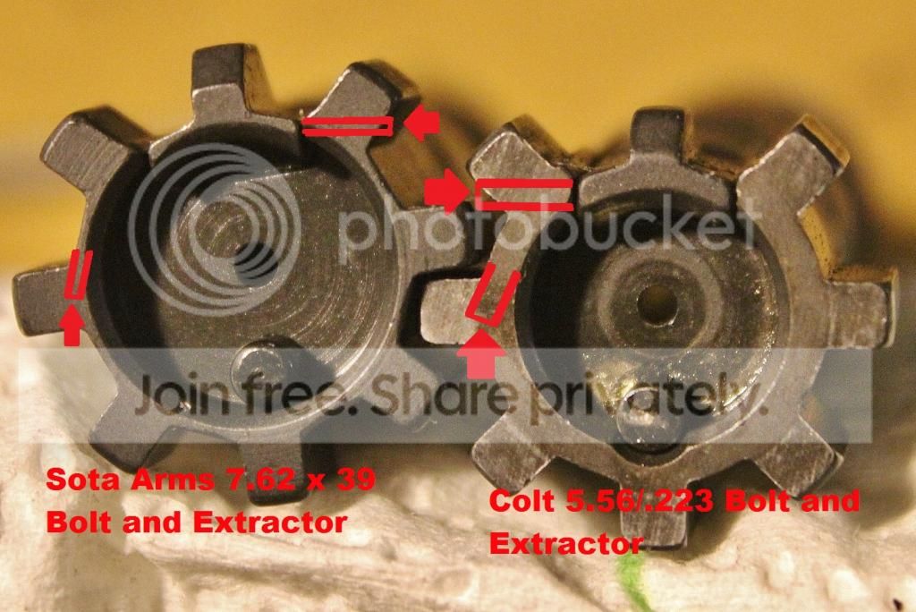

I'm not an expert by any means (about to start my first build though), but from what I have read, the bolt face for a 7.62x39 is thinner around the edges, because of the larger head diameter. This was part of the reasoning for the 300 blackout.
Seems like it would be a lot easier to shear a locking lug on the 7.62x39... That and cleaning.
