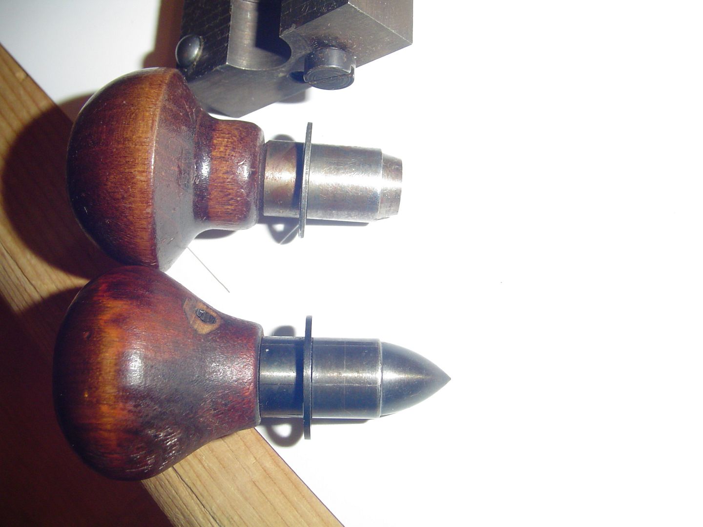

I have the PH 58560 mold, and have been using that with the flat base plug , but I also have the old OHAUS mold from the original pic posted- with a cone-shaped base plug. Next batches of Minies will be from that mold and plug. I think it is basically same as RCBS or Lyman mold. Once I get enough I will do a trial of both types to see which my Musketoon prefers. What do you suggest for starting load of Goex Black powder? Was going to try 45 grains and work up from there.

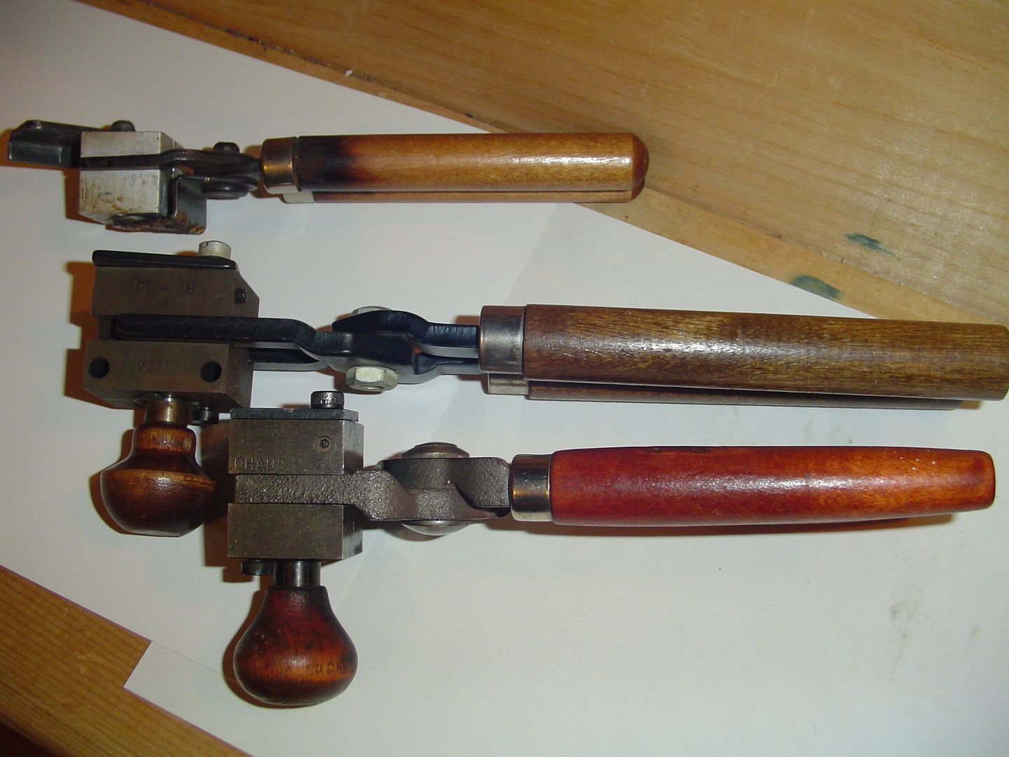

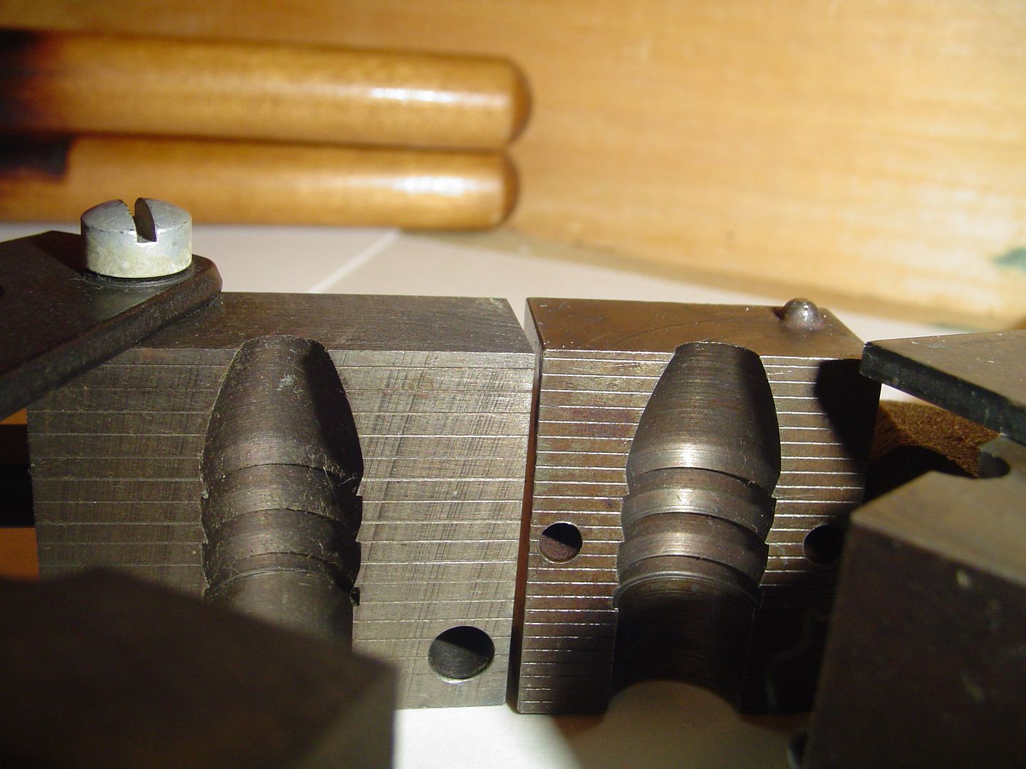

I seem to have good results with the PH mold once it's hot, I try not to overheat with the torch , once it's moderately hot I start casting. It takes a lot of heat to get up to temp. The original PH mold is huge, almost twice the size of the OHaus I am going to try next.
PH on left, Ohaus on right:
PH bottom plug on top, OHaus on bottom:
And for comparison- A Lee aluminum 500 grain mold on top , PH in middle, and O Haus on bottom:
