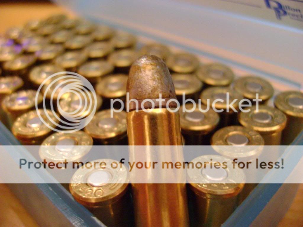

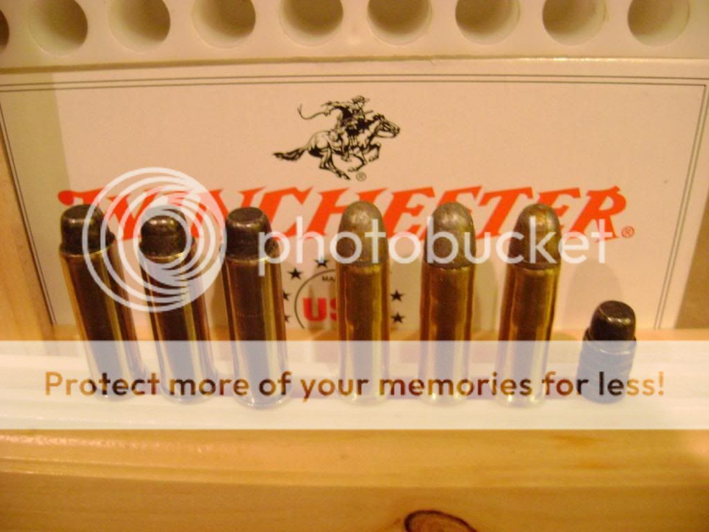

cracked case mouth
Check your overall length. I like to use a case gauge as well to be sure the ammo is sized properly. The case looks abit overcrimped and maybe bulged abit. Does it fit in your chamber, are they tough to remove after shooting?
Safe to use that brass for the last time.
You don't really need too much of a crimp or flare the case out too much when adding the powder. I like to flare and crimp as little as possible and was reloading my 38 special up to 7 times ( light loads) before cracks started to appear. More use out of the brass, saves $$.
I'm guessing you bought a couple good reloading books. I really like the Lee Reloading Manual, tons of great info. The more good safe info we can read the better.
Great close up photo, that helps.
