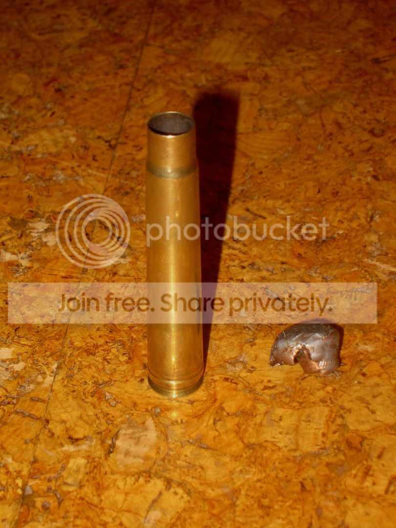

I am with Boomer and Headcase. Using Ken Water's "Pet Loads", 76 gr 760 and 300 Gr Partition gives me a 3 shot dime size group at 100M. I have shot deer, black bear, blue wilderbeast (Gnu) and this year a waterbuck. The bullet expands as it meets resistance. I have had NO meat damage on any animal shot. One black bear turned as I shot and blew out the collar bone. That one was the worst damage. The energy vaporises heart lung shots on deer. This year's waterbuck was shot in very windy condutions and anunstable set of sticks. It completly destroyed the liver. The animal still managed to do about 50 feet and lie down. We waited 15 minutes. As we walked up, it got up and very slowly walked. The second shot severed the neck bone. Here is the 50 yard neck shot on bone. it was recovered under the skin on the other side:
