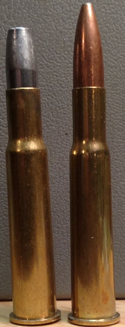

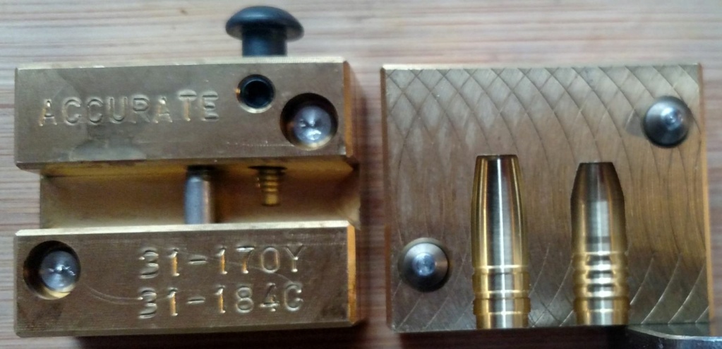

I have mould with a separate design in each cavity from Accurate, that by happy coincidence works not only extremely well in the Long Branch I designed and intended the bullet designs for, but also my Grandfather's old 1895 Winchester (circa August 1898) in 30 U.S.

The short story related to the question of what mould designs to use is this: by adjusting the fit of these two designs to the two different throats and ball seats, I get extremely good accuracy out of both. Although each rifle takes slightly different operations to get the right fit. The result is particularly impressive in the 1895 Winchester (think similar badly worn Lee Enfield) that with jacketed bullets, isn't much more than a 50 - 75 yard hunting rifle. With the WFN cast design and rear aperture sight, it's now a legitimate 200 yard hunting rifle.

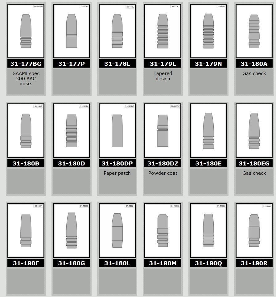

In my case, I quickly learned 314299 was mediocre, even unsized (this is long before powder coating), and I opted for a custom mould made to size. I started with moulds made by Rob Applegate (before the magazines made him famous and the demand for his established designs led to him abandoning custom mould work). Since then I've found that Accurate is really good to work with getting moulds that turn out bullets that measure precisely what you specify. Now that powder coating has changed my life (well, almost), I'm going to have to order another set of moulds - the fit on the original moulds is now a wee bit too fat after powder coating, so I need some dimensions cut back a couple of thou...

I'd upload some pics of the Accurate designs I chose and modified to use in my Lee Enfield, but apparently I have run out of space. Have to do something about that...
