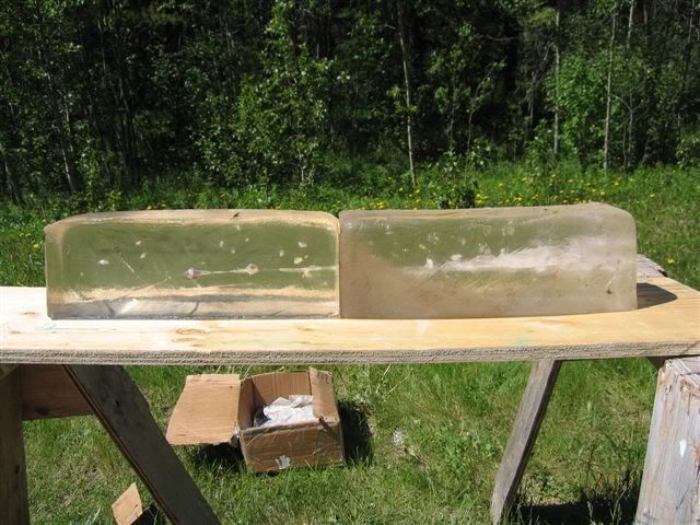

None of the bullets above tumbled. A bullet may impact in a yaw but this is a far cry from one that tumbles upon impact. Expansion of the nose of the bullet moves the center of gravity to the nose, so it would be all but impossible to tumble. The bullet's shape and construction combined with it's momentum has everything to do with how well a bullet penetrates.
Sheep hunter, why is it then that nearly all (most) of the bullets I have recovered from wet or dry phone books, clay, trees, rice, are found with the bullet facing forwards. Most of the ones I have found that were facing backwards or askew had lost the jacket, or were expanded to the point that the bullet was wider than it was long.

sheephunter the large size of the entrance hole is due to the bullet expansion on impact. Then once that expansion has occurred the bullet continues forward and the wound channel remains that size unless something else is struck like a bone that might cause further expansion or deflection.
Btw where do you get the ballistic gelatin? What's that stuff cost?
Sheephunter,
How do you establish that the greater damage is caused by the bullet tumbling, and not simply by the higher velocity at entry?
I've recovered bullets from animals (the best test medium) and I've found them to have held together, turned to shrapnel and everythign in between.
But I can't say that many of them have tumbled.
All the ones that hold together (X bulet, TSX, Partition, Accubond) have been recovered pointing in the correct direction.
I've also seen the high speed filming of bullets in ballistic gelatin that show bullets going forward, not tumbling.
I'd like to see where sheephunter came to his conclusions that bullets almost always tumble. The photo of the ballistic gelatin really doesn't tell us much. It's difficult to even see the bullet.
