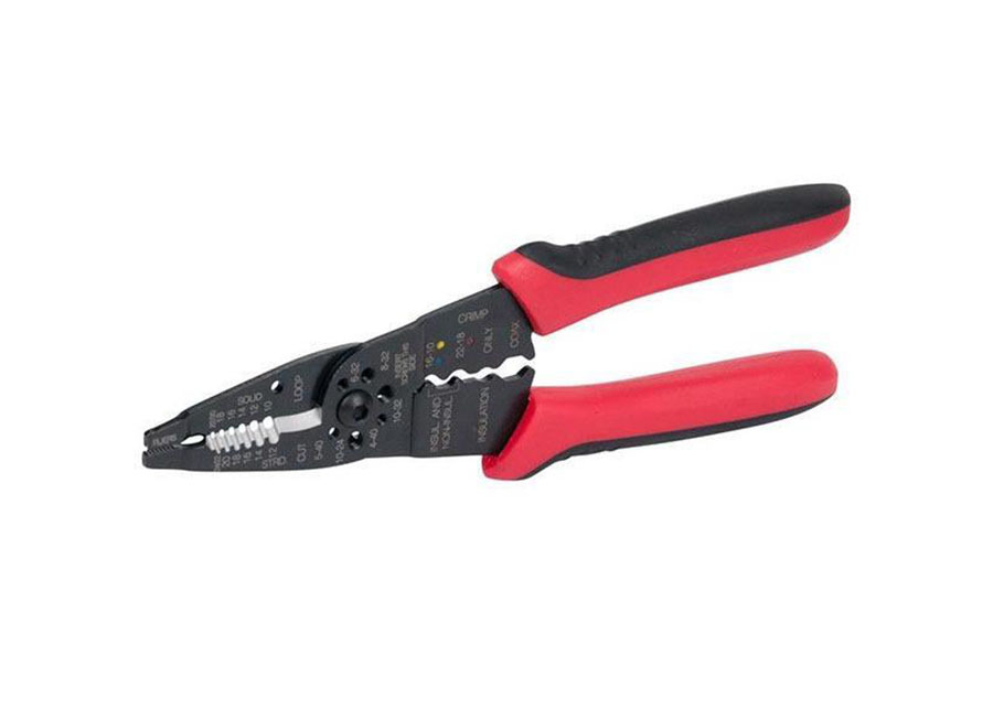

OP, you could probably get a pair of wire strippers and Dremel out the holes to fit. Make a poor man's grip n pull.
So why are you pulling 9mm bullets? Incorrect charge? Too light? Too heavy?
That's a clever hack Suther!
