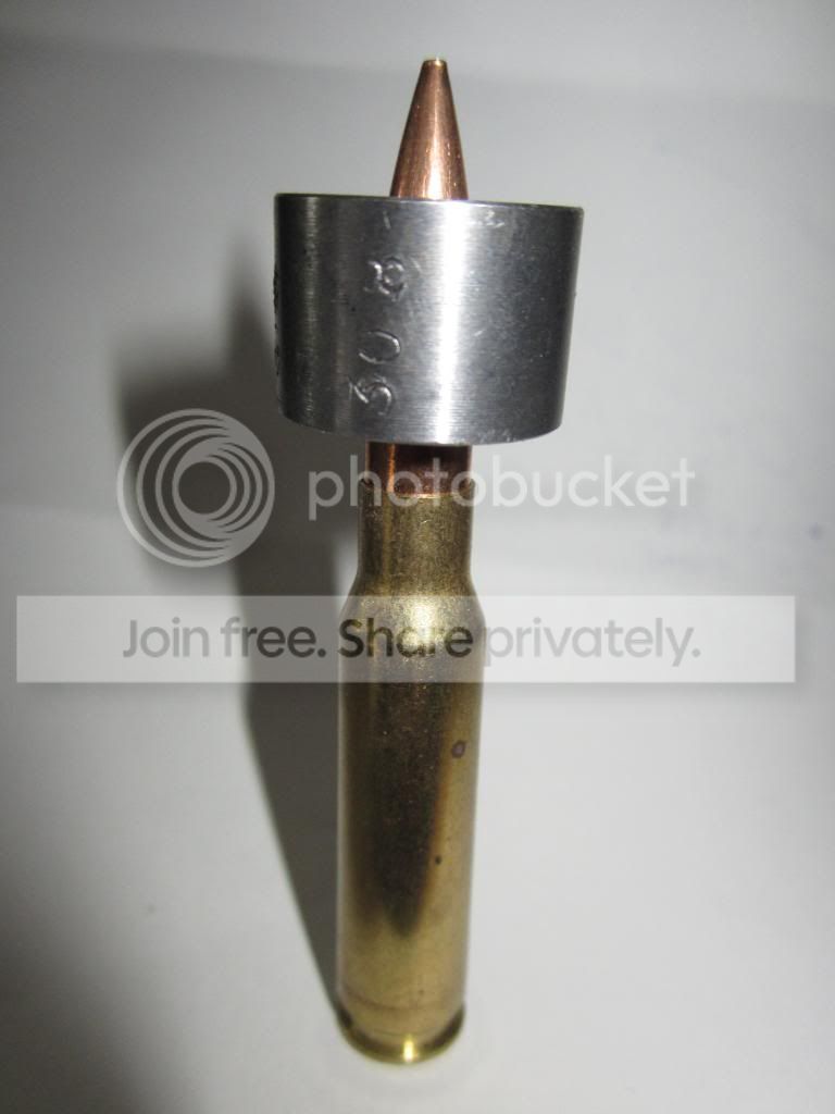

You are measuring to the tip of the bullet. But the die pushes the bullet into the case by pushing farther down on the curve of the bullet.
Bullets vary from one another with respect the distance from the ogive to the tip. Especially so with hollow points.
The manufacturing process is such that this distance is not well controlled and also, with some (most) manufactures, there are several machines making the same bullet and you box of bullets came from 2 or more machines.
Your rifle only cares about the distance of the ogive to the rifling. The Tip to rifling is of no consequence. If you want to measure OAL that matters, make a device that sits on the ogive. I make little collars from pieces of scarp barrel, and then measure from case head to the top of the collar.
