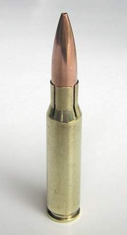

My understanding is that you just want to seat the bullet off the lands of the rifling and the way to find this is via the dowel down the barrel method or making a dummy round and marking the bullet.
I have done both and both ways are telling me that the bullet is touching the lands at 2.71" with a 155 Sierra Match. But load data has been having me load this particular round with an OAL of 2.775 and my 168's 175's at 2.800". So it seems to me that I am WELL into the lands and may explain why 46.5 grains of Varget behind the 155's give me an occasional tight bolt even though I am not at max load.
