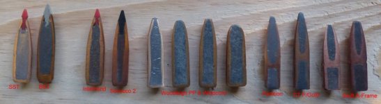

bullet sections- woodleigh partition swift etc

What is a CT/P gold?
It's a Combined Technology bullet. Made by Nosler/Winchester. I've shot quite a few over the years and I find they are better than the Nosler Partition.
They still make the CT Ballistic Silvertip which is a version of the Nosler BT. And I shoot lots of them too. It looks to be the 2nd from the left.

So they don’t make that bullet anymore right?
The Accubond is still the premium bullet the other manufacturers just make there version of it
The idea of bonding core to jacket happened long before the Accubond came about! Soldering the core and jacket together was invented from an elk hunter in the 70s And then came the Trophy bonded bear claw and the Swift A frame then polymer tips all long before the Accubond. So the Accubond being introduced in 2003 is the newer kid on the block with the best of many ideas combined into this projectile. Accubond is the copy of other manufacturers.
I like that the polymer tip is bigger in diameter on the Swift Scirocco as opposed to the Interbond, tougher bullets can sometimes struggle to open so having a bigger meplate is an advantage in my opinion.
Z
The stepped jacket of the inter bond is evident in gel tests I've seen recently, certain frontal petal but slowed expansion later on there .
I agree with the slightly wider cavity /tip

I have a 30 cal, 180 grain Scirocco II recovered from a Bull Moose I shot a while back.
It is a classic mushroom, and devastated the lungs of the moose. The shot was about
100 meters, and my 308 Norma mag starts that bullet at just over 3100 fps. I was
impressed with the way the bullet looked when recovered. Dave.
