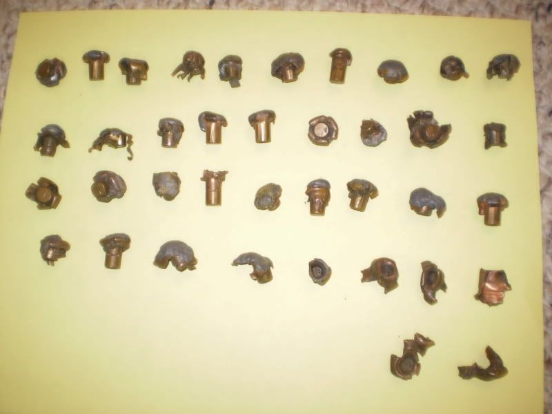

I have been a bullet-picker all my life, and have collected a few over the years. First, I have a picture of all the standard cup & core bullets, most of which were from my earlier reloading/hunting days. Here is the picture. You will notice that in some cases, very little of the bullet is left, whereas in others, the bullet looks extremely nicely mushroomed. It all depends on how much heavy bone is encountered by these type of bullets.

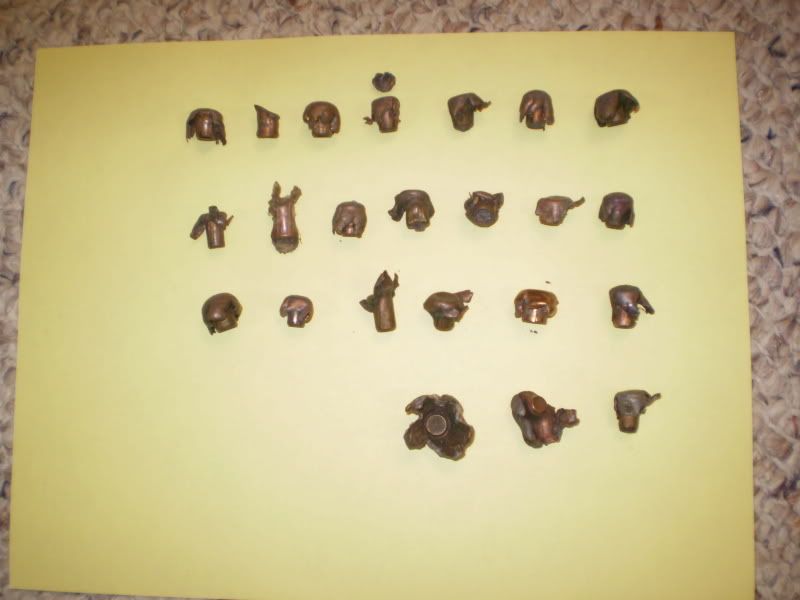

In this following picture are a number of Partitions, including the one from this year's moose [third row, RHS] the three on row 4 are various bonded bullets. #1 is a Blue Point, #2 a Scirocco, and # 3 an Accubond. As I have mentioned before, the recovery percentage for Partitions In my experience, is about 17-20%, with the remainder making exit. The Partition has been flawless for me over the years, and I have shot just over 100 head of game with them now. [since 1965] Bone makes little difference to the Partition. They generally will drive through into the vitals even after encountering such resistance. Here are the pics. Regards, Eagleye.
Very impressive - you didn't get all those sitting in your rocking chair at home.
Do you think the accubond will hang together as well as a partition - even when encountering bone? Some have reported it as such. If the lower RHS bullet is your accubond it looks like it held together.

Since my experience with the Accubond is relatively limited in comparison to the Partition, I cannot say if it will always stay together. However, the one in the picture took a nice muley at about 200 yards. It was a 140 AB from a 280Remington, started at just over 3000. It weighs 112.5 grains, which is pretty decent retention. [about 80%] Partitions typically retain from 60% to 75% of original weight, regardless of what they hit in the animal. Regards, Eagleye.
